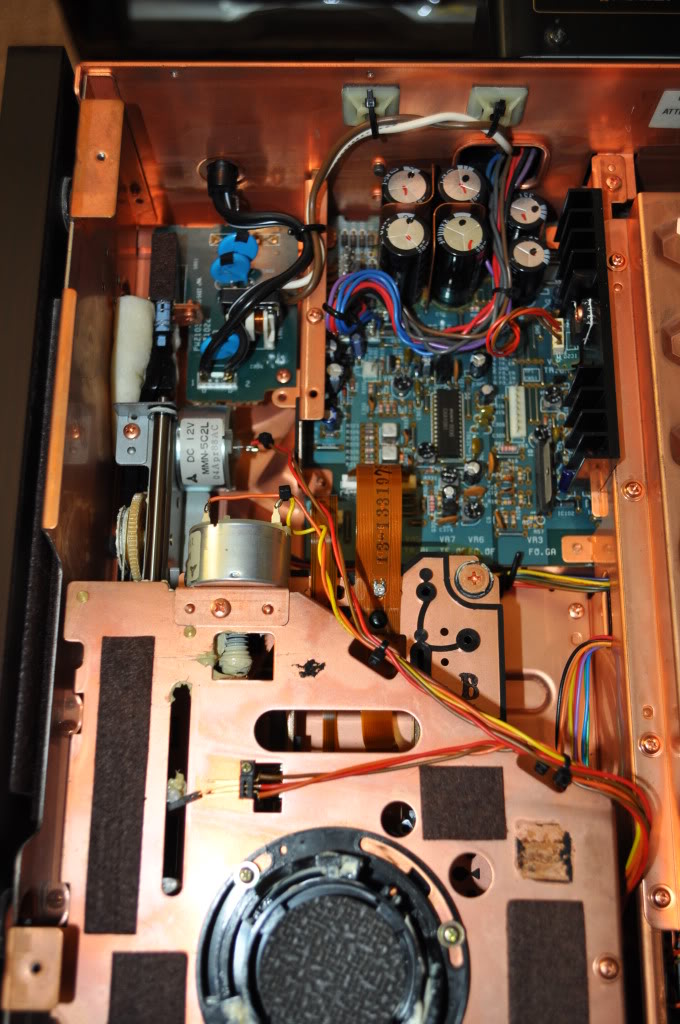

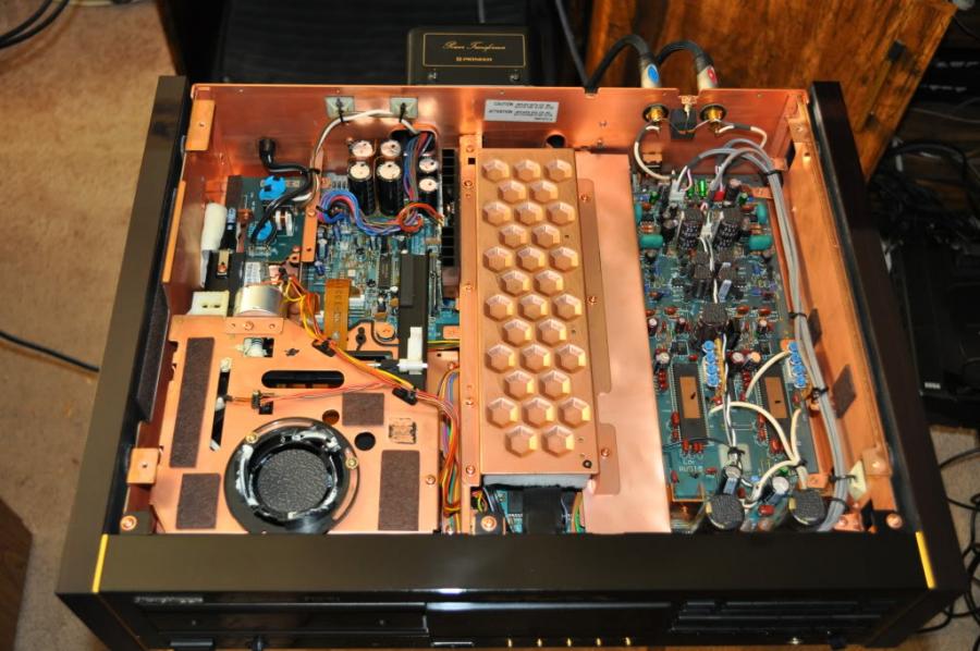

- PD-91, with top aluminum panel removed -
((NOTE, unless you have modded this player as i have, and bummed the alum top plate from
from either the Japanese market PD-3000, or -5000, or from the U.S. PD-93,
then your U.S. and/or EURO/WORLD version PD-91 will require removal
of 16 screws, both rosewood panels, and the pressed sheet metal top bonnet
in order to gain access to the player interior))

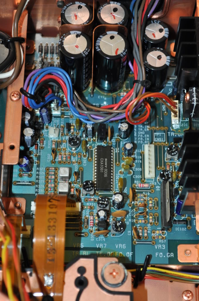

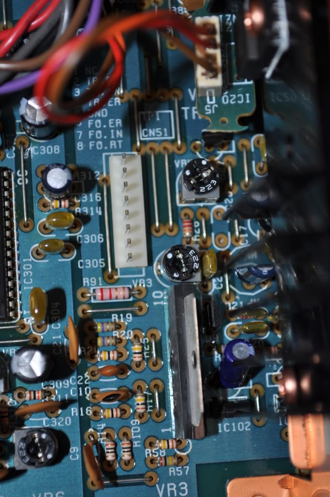

now then. there is a series of Variable Potentiometers on the section of PCB directly aft
of the disc transport cage/assy;
there are only TWO of these that you want to mess around with.
VR-3 and VR-4, FOCUS GAIN and TRACKING GAIN, respectively.
BOTH are located at the far right, right beside the black-anodized heatsink
vertically mounted on the central stay/DIGITAL section shield;
you will want to adjust these, counter-clockwise, to the positions shown
in that photo directly above.
