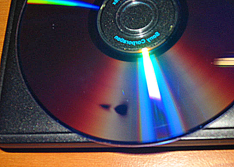

1 I always wash my hands before handling the medias, I possess few DVDs with dark spots but do not know if it is fungus but these discs are still functioning
2 My friend has discs with transparent dots that increase over time and do not know what is
Here are some pictures of discs: http://i797.photobucket.com/albums/y...ampleBelow.jpg
http://upload.wikimedia.org/wikipedi...4/Disc_rot.jpg
http://www.lifetimememoriesandstorie.../disc_rot2.jpg
I have some bad news for your friend. Those pictures looks like a good example of a dangerous DVD fungus.
Are your sure you "friend" isn't Google?
Because none of the photos are fungus. See my next post.

This topic annoys me, because people say things without knowing what's going on. First off, there is no "DVD rot". That's a stupid myth, based on something that happened to pressed Laserdiscs in the 90s, thanks to cheap (inferior!) aluminum. It has no translation to CD or DVD. Nothing "rots". This isn't fruit in your refrigerator or on your cabinet.
The images show 3 things, NONE of them are fungus.
1. That's a pressed CD, with a pinhole in the foil. This is often manufacturing defect (CHEAPSKATES!) when the area was too thin. Over time, it developed a hole. The disc may skip on that area.
2. This is a DVD-R, and that's a defect in the dye. It's always been there, from before it was burned. It's a bad disc, toss it.
3. Again, pressed CD, and the top lacquer and foil have been damaged -- likely from improper storage.
Stop looking at random photos of bad discs on Google.
