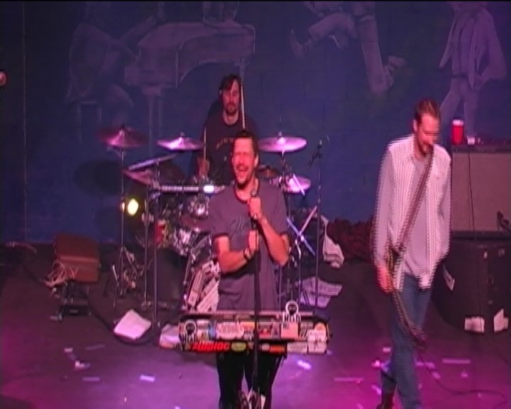

premiumcapture, what I would suggest for your test is to use a digital source over analog and even test multiple devices. That way you can compare to the source. I did that previously but my original source was already DV output over RCA. If you have non DV digital source and the right card to output over analog that would be ideal.

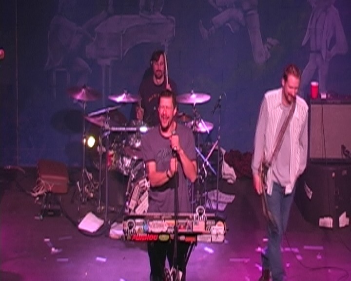

The point is you can compare you digital capture to a digital source. You need a control because you can;t go back to the VHS and make a comparison.
I posted these previously, here is screenshot of the DV transferred over firewire (note the images are 720*576 but should be 720*480). Not sure how I managed to do that but it was years ago. Wrong template in the editor so they both went through same process. Also note they are two slightly different frames.
Here is the capture from S-video using a Canopus.
The criticism here is my source is already DV, if you can use a neutral source such as lossless capture from some other card that can provide output to your capture device then you can really make some comparisons becsue you can compare to the source.

Correct but that is not the point. If you are going to compare the capture abilities of any device how can you make any really comparison without a digital source? You are purposely taking the DV or any digital source and converting it back to analog ro send it to the capture card.
This is what my source looks like:
How well does the Canopus perform? Well we capture from the camcorder over S-Video which is analog. Here it is, now you can compare it to the original above which is wht it is suposed to look like.
Now do I want to see how well a camcorder works as passthough? I can do the same thing.

1. DV Camcorder >> Firewire to computer >> Screenshot to compare captures
2 DV Camcorder >> S-video >> Canopus >> Screenshot to compare to 1
2 DV Camcorder >> S-video >> Camcorder using passthough >> Screenshot to compare to 1
3 DV Camcorder >> S-video >> <insert any capture device here> >> Screenshot to compare to 1
Get it?
