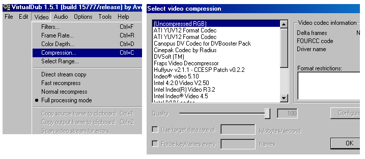

The way I convert MPEG back to AVI is to use the free tool VirtualDub, the one that will read MPEG-2 files. You can find a version of it here: http://fcchandler.home.comcast.net/stable/index.html. Simply start the software, open the MPEG-2 video file that was made by VideoReDo (it will take some time to read the file), and then "save as" AVI (by default, uncompressed AVI is the output format for video).

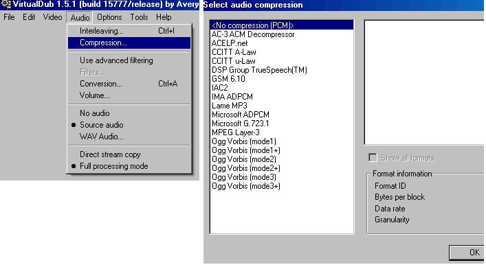

You may need to also enable "full compression mode" under the audio menu in VirtualDub, and then go under "compression" option and select uncompressed WAV/PCM audio.
This should output an uncompressed AVI file for you, which contains both uncompressed audio and video. Now, realize these files are large. Video editing requires a massive amount of space. Uncompressed video occupies 75GB/hour of space. So you'd better have a large hard drive (for example, I have 1TB of space on my main editing system). If you cramped for space, let me know, and we can look at trying to use a compression format like HuffYUV temporarily, which uses about 25-30GB per hour of video.
By converting to uncompressed AVI, there is no loss of quality. When you edit and output the video, all you must do is choose decent enough settings so that the output is not too much lower than the input.

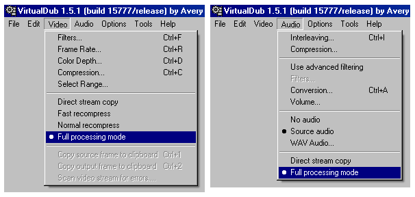

Take a look at this, for the FULL PROCESSING options:
Make sure these are both set AFTER you've opened up you file.
Under the COMPRESSION menu, pick PCM audio.

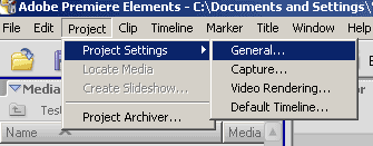

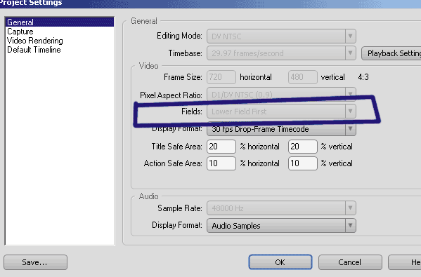

This is the wall I run into, using Adobe Premiere Elements 2.0. The projects settings refuse to change to top-field video, the option is grayed out. It's set to bottom-field (DV video), and may be static since this is DV-audience software.

I tried with two different files and got the same result (it won't allow the top-field setting).

That's all it is then. Your interlace threshold is reversed on your output, and is why the video looks bad. I'll have to keep this mind. It seems Elements is truly a DV-only solution, totally worthless for anything else.
I can only guess at what Premiere Elements was doing to your video file. It was probably de-interlacing and then re-interlacing as bottom field. That must look dreadful!
