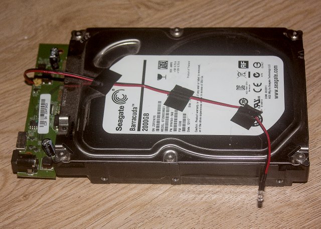

I've got a Seagate 2TB USB 3.0 External HDD for the past approximately 3 years.

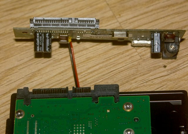

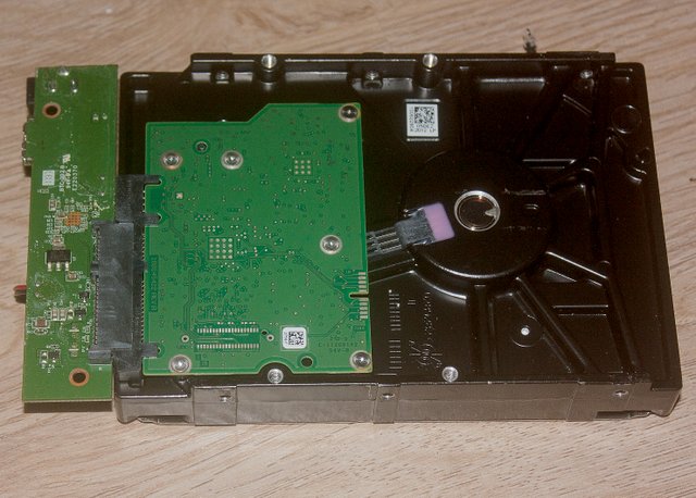

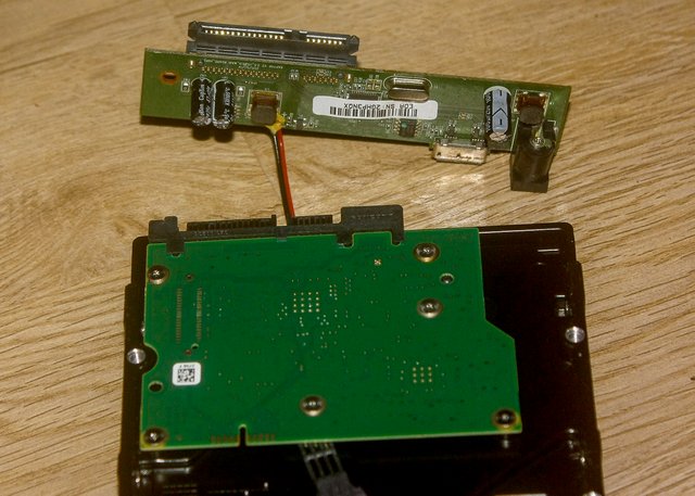

At some point a year ago, my desktop did not recognize the HD. It appeared as if the enclosure blocked the cable to properly insert into the HD. I removed the enclosure (a job!!) and for a time it was working fine.

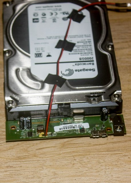

Now for the past months, it lost contact again when I moved the HD. I finally got it on top of the PC box, where it made contact and I taped it with insulation tape to the box.

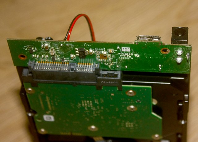

Unfortunately, I moved the PC last night and again, the PC does not recognize the HD.
I tried 2 different USB cables, moved the HD around and one can hear and feel the HD starting up, sometimes even the little light would go on, but nothing appears in Explorer.
I will provide all the specs later in the day- I have Windows 8.1; i5; but all the other detail, I cannot remember.
So, why does it feels as if the HD is starting (?partially) up, but nothing further happens?

I removed my internal 500GB HD and connected this 2TB ext HD to the mother board. Works perfectly.
You've described typical flaky Seagate enclosures here.
Yep, it was just the enclosure. The drive should purr. Sadly, you spent about 25-50% more for the drive enclosure. So it was an overpriced internal drive in the end. That;s why you should get a Fantom for external.
