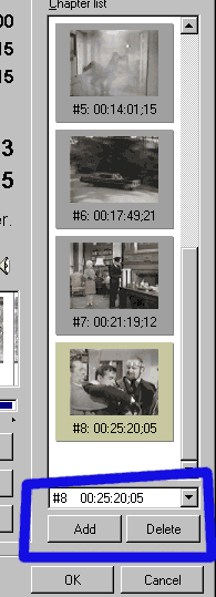

In the edit clip screen I delete the first chapters showing up on the right. If I hit OK, return to the main menu and then hit "edit clip" it shows up again. Is this because it is the first frame in the clip? Should I be doing something else to save my work?

I was just trying to set all my chapter marks. I think the problem was that the first frame was part of my clip so it had to be a chapter mark by definition. Once I set my frame beginning to further into the clip that chapter mark went away.

- You are correct, the beginning of a clip is a chapter, and there is no way to change that. That's is how the DVD-Video format works.
- There is also a limit to how many chapters can be put in a video clip, and how far apart they need to be. Software reacts differently all the time. I've found TDA to act oddly if chapter marks are closer than 3-4 minutes apart. That's honestly close enough anyway. You can put some 30 seconds to a minute apart too, but do not make it too often (else the software may crash). There is a limit of 99 chapters.
- The way to delete bookmarks in TDA is to use the toolbar on the right side of the TDA interface. It is also the best place to insert a chapter mark based on a precise second in time.

Thanks. Once I realized that I needed to redine the starting frame, I could set my chapters correctly,
