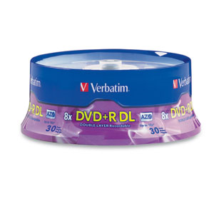

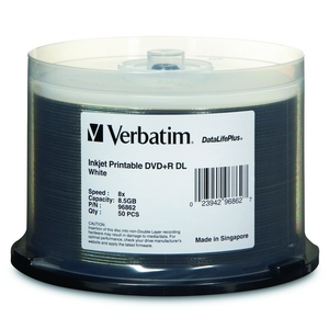

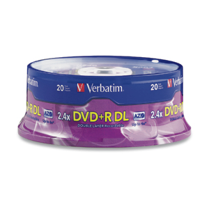

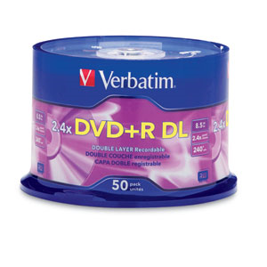

Up until now I have been buying only Verbatim (MCC) SL DVD+R media from Sams Club because it was convenient, cheap, and reliable. Recently I went there to get a new supply only to find that they had replaced the best Verbatim MCC SLs with mediocre-at-best Memorex Indian-made discs. While I was there I was surprised to learn that 1) - they had DL discs and 2) - they were so cheap - less than $40 for 50. So I bought a spindle and took it home. I had to read the disc data to find out that they were second-tier Moser Baer discs. So they are going back and now I want to buy some Verbatim DLs online. I have read as much as I can stand about the various manufacturers and brand names of Verbatim discs here in the forums. Now I just want to buy some discs. I read somewhat conflicting views on what is good and what is not. Clearly DataLifePlus seems to be the first choice but what about lesser choices? Again, I see discussions and listings of the various manufacturers that actually make the discs and, one post ( http://www.digitalfaq.com/forum/show...04&postcount=2) goes so far as to say that Quote:
as long as the discs are the "good ones" (NOT Value Series, NOT Life Series), then it honestly doesn't matter
So my question is, what is the difference between the DataLifePlus series, current PNs 95123 and 96862, at around $1.75 each in packs of 50, and the other lesser brands, PNs 95310, 96542, and 96577, at around $1.00 to $1.40 each in packs of 30 to 50?
Please answer only if you have knowledge of or experience with these brands. No speculation please. I need hard data so I can decide muy pronto, man.

DataLifePlus, DataLife and AZO are all marketing terms or sub-brands within Verbatim. Right now, they all mean the same thing -- the "good discs" made by Mitsubishi. (AZO is actually a trademark for the dye materials used by Mitsubishi.)
The ONLY differences in the discs you've linked to is:
- burn speed -- 2.4x rated vs 8x rated
- surface materials -- inkjet vs branded
... and that's it.
The 2.4x discs are best burned at 4x in Pioneer drives, or 2.4x in anything else. The 8x discs are also best burned at 4x or maybe 6x -- better burns, less fails. DL media is still somewhat picky/touchy, even in the highest quality discs made.
Inkjet surfaces made for printers, branded surfaces for not printing. You can handwrite with a nice Sharpie market on either one just fine -- I do that all the time.
Those are all good discs. Buy based on price, the number of discs you want, and whether you need inkjet surface or not. Speed should not be a consideration -- not really.
I would suggest Amazon and Meritline have the best prices and shipping speeds. Those are the stores I've come to trust most in the past decade of blank DVD buying.

Inkjet surfaces cost more than branded surfaces.

So is that the only difference? Is the AZO coating the same?
Another question. Are the 8X discs inherently higher quality than the 2.4X, i.e., given that both are available for the same or similar price, should you always buy the higher speed discs? This assumes that you will not burn at the highest speed as discussed above.
08-31-2010, 07:18 PM
Posts: 4,310
Thanked 654 Times in 457 Posts
From the links/images you posted, yes, the inkjet surface is the only difference.
AZO is not a coating. AZO is the name of the metallic-stabilized dyes used by Mitsubishi for CD-R and DVD-R.
The 8x discs are not necessarily better, no. There is some empirical evidence that shows the 2.4x media may be superior to 8x discs, but the variables are not always fully defined, so the statements are inconclusive in my opinion. I would suggest either disc is fine for your use. And I would burn 8x discs at 4x, using a known-good burner.
My personal preference is for 2.4x media, but it's mostly due to price, easy availability, the ability to burn 4x in my Pioneer drives, and that I have about 200 of them on the shelf. I have nothing against the 8x discs, however.
