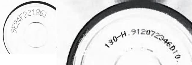

Trying to authenticate the timeframe that two discs were created based on the physical numbers printed on the center of the disc. Wondering if anyone here would be able to assist based on the number formats or can point me to a reference? These CD-Rs have no branding/labeling on them whatsoever other than the numbers.
From feedback received on other forums they are Ritek and Verbatim, but I was wondering if anyone had an actual reference to interpret these stamps to dates (even if it's just a year).
Regarding my intent, the timeframe of when a disc could have been created can be important in a legal matter. The manufacturing info just helps to provide a frame of reference (for example if the media was manufactured in 2005 but someone claims they were burned in 1999, that would be an issue).
Thanks in advance for any assistance.

There's two ways to get assistance on this.
1. Asking the online community. What we'll need to see is not just the hub code, but the media ID on the disc, as well as a photo of the disc itself (assuming it's not been covered up with a label -- in which case it needs to be removed). Disc manufacturers change the media ID for every new generation of disc, and they change the brand markings every year or two. By triangulating those features, we can often pinpoint the media to within a few years.
2. Asking the manufacturer. If this is indeed a legal case, the opinions of the online community won't count for much. You'll need an expert witness, or some sort of documentation from the manufacturer stating what the batch code means, and hopefully connecting it to a manufacturing location/date. Given the number of mergers/bankruptcies that have happened in the past, that can be impossible. But if the disc is truly Ritek or Mitsubishi, then you may be in luck, as those manufacturers still exist today.

Thanks for the prompt reply. Unfortunately these discs have no branding or labeling whatsoever other than the hub code. I have forensic images of them and will look into the media ID. Is there a reference for the different media IDs and what they may look like?
Regarding the manufacturers, I've looked into that but only found dead-ends. Do you or anyone on this forum have current contact info for these types of requests?

I can say with 100% confidence that the second CD-R was made by Ritek in 1999. Ritek's serial numbering is very easy to decrypt and hasn't changed for more than 12 years.
Dating the age of older Mitsubishi Chemicals (MCC) made CD-Rs can be a little tricky - they had been manufactured in a number of different facilities in a different countries (Ireland, Japan, Mexico, Taiwan) and thefore, the serial numbering style is different.
But, I have got about 20 Verbatim AZO CD-Rs, that were made in 1998-2001 and their serial numbers always begin with "8" - "1" or "V8" - "S8" / "S8" - "S1" so it is pretty safe to say that the second made was made in 1999 as its serial number begins with "9".

Admin, I don't have the discs in my possession, just forensic images of them, so I can't use software to find the media ID. I tried mounting an ISO as well but every piece of software I tried only sees physical devices.
Regarding the 130-H.912072346D10 serial, on another forum pepst has already decoded this as originating on July 12, 2009, based on the numbers after the ".". Does anyone know of documentation available to confirm this? As was mentioned earlier, it's hard to substantiate things to people in the legal community without stronger supporting evidence.

Except for this link (that I already post on the myce.com board and which describes the serial numbering system used on Ritek's CD-R and DVDr media) I can only advice you to try to contact both companies directly:

Also, to clarify your earlier comments Pepst, both discs start with a 9 in part of the sequence:
130-H.912072346D10 (is Ritek/AZO according to ATIP interpretation done by software at time of imaging)
9E24F221861 (MCC/Azo)
Did you say that you're 100% that the 9E2 disc is Ritek from 1999 or were you talking about the other one? I wasn't sure if you meant one of them was a Verbatim serial and other is Ritek or if Verbatim was made by Ritek and that's how you knew about the 130-H disc.

I was talking about the "130-H.912072346D10" disc, which was made by Ritek and that I am 100% sure that it was made in 1999. The second disc (made by Mitsubishi Chemicals/Verbatim) seems to be made in 1999 too, although not with 100% certainty.

The first disc with the serial number of "9E24F221861", is a Verbatim CD-R disc. This disc was manufactured in Taiwan on "F"ebruary "24", 199"9". In the serial number, the "9" means 1999, the "24" means the 24th day of the month, and the "F" means "February". This disc is an AZO Blue Dye disc (which has a "blue" bottom and a "white" writable top) and has been out-of-production since late 1999. They were "extremely" unreliable and that is why Verbatim ceased production in 1999. There also had a tendency to "decompose" (the AZO "blue" plastic would peal off). Verbatim America's LLC. Customer Support Number is: 800 538 8589. I am also 100% positive that the Ritek disc was manufactured in 1999 and is out of production. Good Luck!
