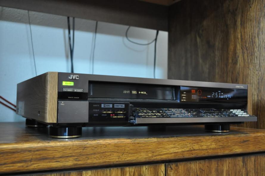

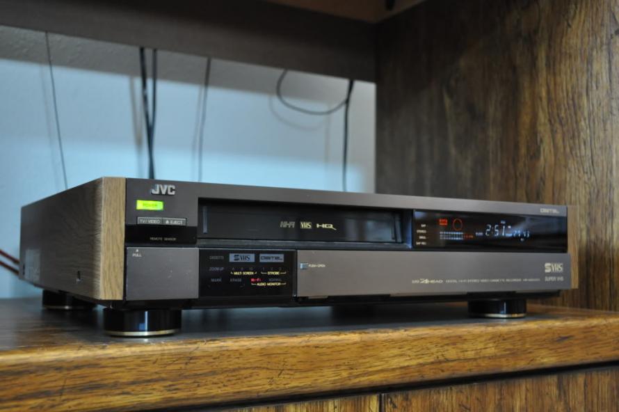

that is INCREDIBLY interesting. i have TWO early-90's FUJI T-120s, both full of that very same "SUPER MARIO BROS. SUPER SHOW" in EP, recorded for me by my mother back around '90 on her 1987 RCA VPT-640HF DIMENSIA S-VHS VCR;
http://i291.photobucket.com/albums/l...VPT-640HF4.jpg
http://i291.photobucket.com/albums/l...VPT-640HF8.jpg
http://i291.photobucket.com/albums/l...VPT-640HF7.jpg
http://i291.photobucket.com/albums/l...PT-640HF17.jpg
very plain-jane, blase' homely-looking VCR, but the stupendous quality recordings it produced in the 5/7 years me and my family had used it spoke for itself, and that includes those MARIO BROS. tapes, which remain very playable and watchable to this day.
alas, that RCA went fluky in the late 90's and, unfortunately, at the time, we were in no position at all to be able to get it serviced in any way shape or form, nor was there anyone in the family with any skill in self-service, myself included.
my mother still has that VCR in storage, however, complete, right down to it's original box, and, first chance i get, i'm gonna take a solid college try at restoring the old girl to good health...

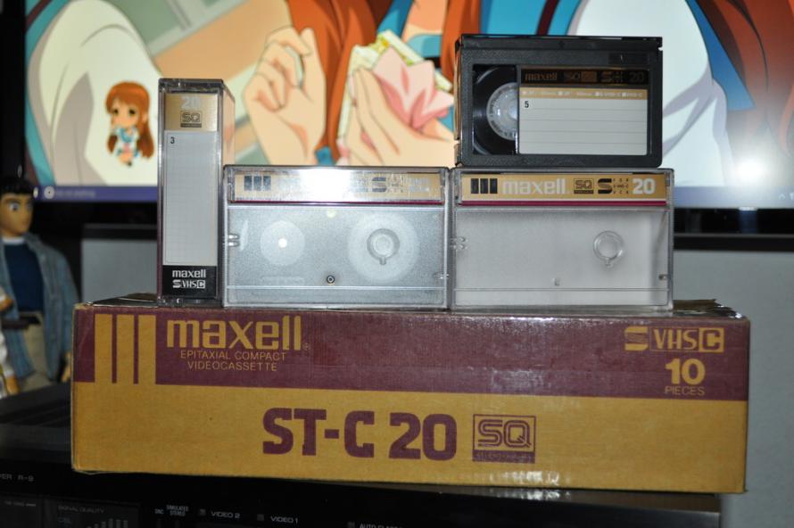

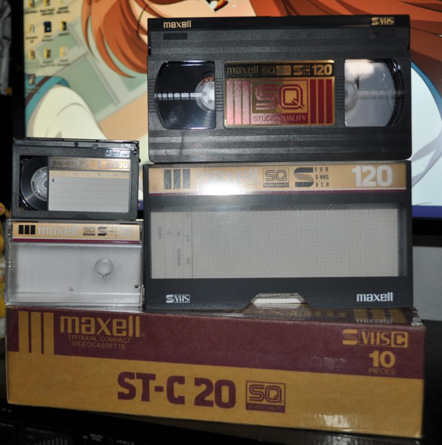

my reference collection, of some of the finest high grade VHS blanks the 80's and early-90's had to offer;
VHS-C CASSETTE ADAPTOR C-P2U;
a complete case (10ct.) of MAXELL's first S-VHSC, and the equivalent full-size ST-120;

Maxell S-VHS never held up, especially late 90s tapes.
They feathered easily (weak grade tape/plastic/film/mylar), and had some color loss.
How are yours holding up? I refer specifically to the 3 at bottom next to those TDKs.

i haven't given them more than a small handful of passes, they seem to be fine enough...
