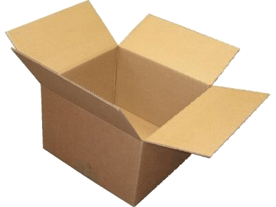

1) I do not have silica gel and in my city does not sell silica gel, to get silica I have to buy on the internet and it is not viable because of the freight, I would always need to buy silica because it does not last the long life, I wanted it a way without silica

9)) I posted that I keep the Mdisc DVDR Verbatim in black case Amaray DVD and I keep the case inside a closed plastic bag tied and I keep the bag inside a closed cardboard box is correct or I have to keep different To maximize the life expectancy of Mdisc DVDR Verbatim?

6. Bags hold moisture. But you location is odd, more moisture outside bag than in.

1 How do I get the best and realistic annual mean of humidity and temperature for my city and discs storage? Last year 2016-2015 my digital hygrometer shows temperature of 31-35ēC this year of 2017 the hygrometer measures 27-32ēC humidity 40-50% I do not know which to trust to estimate the correct of my optical discs, I live in the city of Limoeiro do Norte state Ceara Brazil
2 I keep the mdisc dvdr verbatim inside case of dvd amaray black, the case inside plastic bag and the bag inside the cardboard box, I put a digital hygrometer inside the closed bag and it rains inside the bag the humidity is high, If it does not rain inside the bag is dry and low humidity, if I remove the bag the useful life of the disks will increase? I keep it in bags to protect it from dust and insects
http://www.digitalfaq.com/forum/imag...ixacom10-1.jpg
http://www.digitalfaq.com/forum/imag...pelC3A3o-1.gif
http://www.digitalfaq.com/forum/imag...DVD_case-1.jpg
3 Does storing the cases and disks inside cardboard boxes reduce the temperature for the disks? If the cases and discs do not fit inside cardboard boxes will the hot wind increase the temperature?

3. Hotter inside box, yes. Cardboard absorbs moisture, so temp effect of lower humidity inside box temporary.
