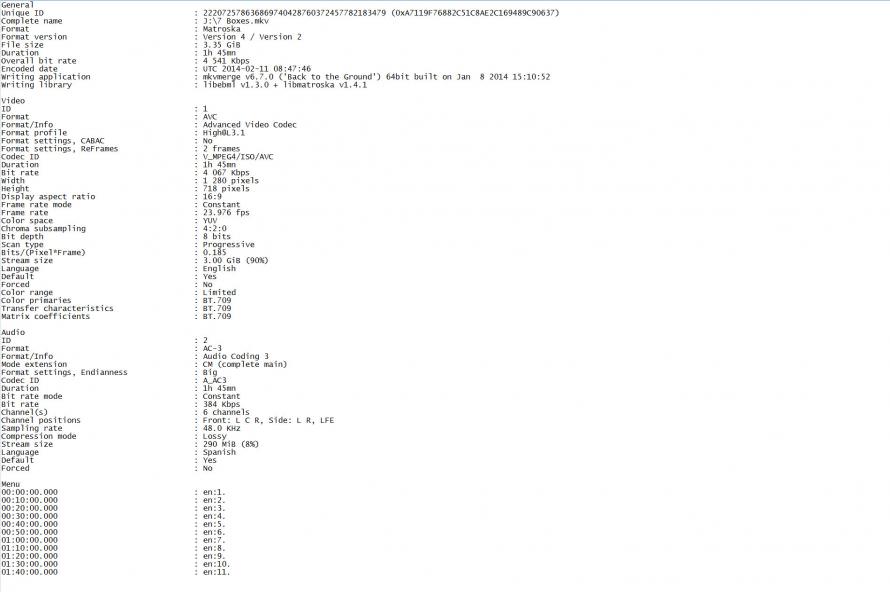

I'm never aware that there are Pro MC and the automated consumer ones. So mine is not so great after all, suck!
Thanks for recommending the "MediaInfoXP". After grabbed it down, loaded the "mkv" into it here what we got:
NTSC dvd is what I want (I am in US). Here the sample of movie that MC failed me:
http://www.rarefile.net/20aedugp9w88/7_Boxes.mkv - 31.4 MB
I don't know how good the original DVD look but I'm pleased with this kind of picture quality, just want to preserve it as much as possible. See if you could tell me more. Thanks

Thank you for the sample. It does present a problem in the form of geometric patterns in the wall tiles that are difficult to downsample without bad line twitter and edge distortion. Overall, the sample clip is below-average quality, re-encoded with a low bitrate that would be more suitable for frames that would be 1/3 to 1/4 its size. The results are noisy and blurry motion during the camera pans, an over filtered, denuded look with most of the original fine detail filtered away, low color density, and other compression problems. Somewhere in its processing there has also been a poorly handled color conversion that resulted in crushed darks with murky or missing detail, no clean blacks, and discolored shadow areas. The overall color balance is too cyan, with poorly rendered flesh tones.
A suggestion: Rather than spend time making tiny-font graphics of screen captures from MediaInfo, it would be easier to just copy and paste the contents of the text window directly in the forum. Below, MediaInfo for your sample mkv as copied and pasted directly from the Text view window in about 10 seconds:

The mod-2 non-standard height of 718 pixels in the mkv will be a problem for some decoders, encoders, resizers, and many type of filters. Other signs of poor pre-processing are the 3.1-second GOP sizes that are non-standard for HD BluRay/AVCHD. I processed the attached "Boxes_DVD.mpg" in Avisynth, then encoded it to telecined 3:2 pulldown 29.97fps DVD-compliant MPEG2 with TMPGenc Mastering Works 5. TVMW5 uses the same MPEG encoder that is in TMPGEnc Authoring Works. The first thing I did in Avisynth was to add 2 pixels of black border to the bottom of the frames to make their height the desired 720 pixels, and took only 2-channel stereo from the audio. I used Avisynth to denoise and downsample the video to 720x480 progressive, then added 3:2 pulldown in the encoder. The Avisynth processing was very slow because of the heavy-duty filtering required to avoid line twitter and to smooth some of the blurry effects from camera pans. Another Avisynth plugin was used to restore some of the original film fine-grain to help prevent the results from looking as decimated as the original. I didn't work on the poor color balance of the original, but left it as-is. The attached mpg could be tweaked, but I ran out of time.
The mpg sample demonstrates that (a) fairly decent downsampling can be done from poor quality, low bitrate originals, but (b) it takes time and patience, and (c) automated NLE's with few filtering options are inadequate for most repair tasks, and (d) different encoders can give different results, for better or worse. It also shows that insufficient, low-bitrate encoding can give smaller files but poor images for proper display and further work. If very small video files are your main objective, you're better off leaving similar mkv's as they are and transferring them to other forms of storage for BluRay players or other playback.
