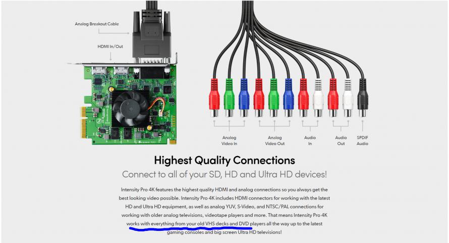

Also, far be it from me to say "I know you said that, but what about this?" but..
Blackmagic seems to specifically advertise the card I'm using, as being perfect for VHS archival. They make some bold claims about it too.
I don't recall old ads where VHS mentioned by format.
Since sometime 2019, their website has actually toned down claims about the Intensity Pro 4K compared to their pre-release hype.
Besides the different formatting, the only difference between my two screencaps below is that they removed the sentence
"Intensity Pro 4K captures better looking video than other solutions because it includes a professional, broadcast grade time base corrector to help stabilize video from poor quality tapes, like VHS and older DVDs."
Oldest version on Archive.org; 2015-03-18
Still claimed TBC as of early last year; 2019-01-25
First archived version with no TBC claim; 2019-06-19 (they have nothing between Jan & June)
galacticboy2009: I wish you would have seen my thread before buying:
https://forum.videohelp.com/threads/...-%28Nope%21%29
I still can't get over how many times that page mentions capturing the output of a DVD player, as if anybody would ever want to do that instead of ripping the actual disc.
