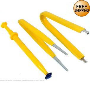

Stupid question: KPMedia, when say "computer tweezers" do you mean "anti-static" tweezers (ie: plastic)? I'm not really getting any results with google and ebay when I type in "computer tweezers" lol.

I put "computer tweezers" into Google images, and this was in the first 3:
Just like the middle one. It's something in almost all (decent) computer tool kits.
Use them only for the the clip -- not the tape (excluding tape right around the clip).

KP, when you say, "no metal", you mean in regard to handling the tape, not the clips, right? Cuz unless I'm wrong, those tweezers are metal on the ends.
11-14-2013, 04:53 PM
Yes, clips.
No, tape.
