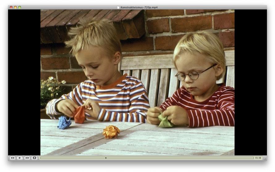

If you want the best results, you will need to scan the film frame by frame, not telecine it. To hide scratches without spending a lot of time doing it digitally, you'll want a wetgate process or a diffuse light source. And scan at 2K or better, non-lossy, with overscan into the sprockets to give more options for framing, and be sure you can capture the audio as well.
If I were to do it for the money, I might consider the MovieStuff RetroScan machine as a "budget" option. Other, vastly more expensive options include Rank Cintel, LaserGraphics ScanStation and so on. Otherwise check the "frame by frame" link above for more budget-friendly options.
With good equipment and software, you can expect results like this from 8mm (click for full size):
The above was using Super-8 Ektachrome 100D film. The forum topic where I found that image is here.
