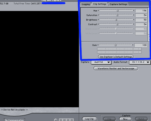

02-11-2005, 06:16 AM
Note this image from the guide:
This is the digital proc amp in the software. I've never used a Canopus ADVC on the Mac, only Matrox cards. I'm not positive the Canopus will have the same options, but it may be there.
