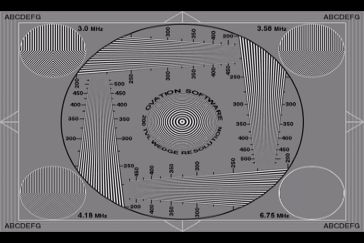

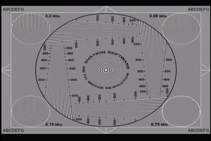

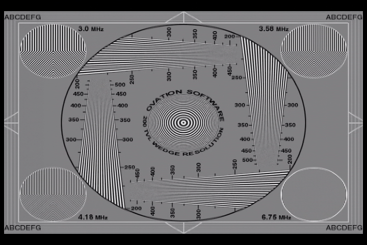

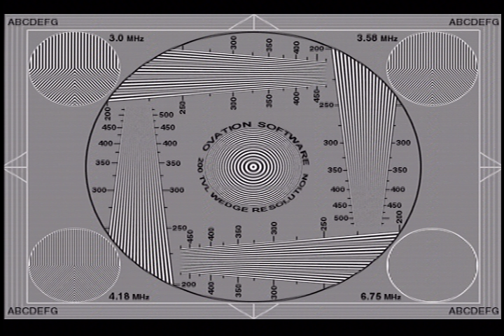

Right now I just did test captures with various settings from my LaserDisc LD-S2 player using composite and S-Video output testing $450 value ADVC-300 and $40 value or so LifeView capture card. For ADVC-300 I used native DV avi codec with 720x480 resolution. For LifeView I used Huffyuv AVI with 704x480 resolution. The LaserDisc I used was Video Essentials. I am posting screenshots. Please discuss.
I'd also like to add that disregarding the price both cards have advantages. ADVC-300 has an audio sync advantage (if it works of course). The LifeView FlyVideo 3000 has an advantage of flexibility capturing sound digitally. I.e. I can run toss link of optical out of my LD player to my soundcard's input and capture audio losslessly at 44.1kHz. Something I will not be able to do with ADVC-300.
File Type: jpg ADVC300 Composite Strong3D YC filter.JPG (54.9 KB, 43 downloads)

It's sometimes hard to get a good feel for quality of NR, when basing samples on test patterns. These all appear somewhat similar, in terms of detail and capture quality. Rainbows are missing on the ADVC captures, but I would think that has more to do with poor handle of color by DV conversion methods, as opposed to it being "cleaner" in an legitimate way. It's also somewhat difficult to 1:1 compare these since DV is bottom field interlacing, and the other capture card is undoubtedly top field.
Still interesting to look at, however.
