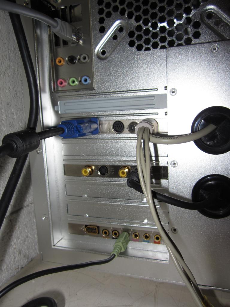

The old computer is an old AMD semperon, 1.81Ghz with 512MB ram, would this be sufficient for capture usage? If the TBC-100 is in stock of course. Also if I buy the TBC-100 I wouldn't need an TV Wonder 600/750 USB right or? I can't see how I could connect these 2 together as the TBC-100 goes straight into the computer.
edit*AH nvm, I see there are in-and outputs on the card. I read it only uses power from the computer and can't communicate with it at all Right so I will still need both.

you dont need a PCI slot.
the card just fits in an empty pci slot for convenience, but has no contacts
(it runs though S-video cables not the motherboard)

pic of tbc-100
