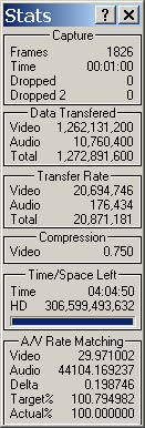

I have a Hauppauge PVR-150 card which I am using with VCR to capture VHS. I want to make sure it is capping losslessly and not encoding at all. VVCR gives these stats post-capture:
here is mediainfo:
