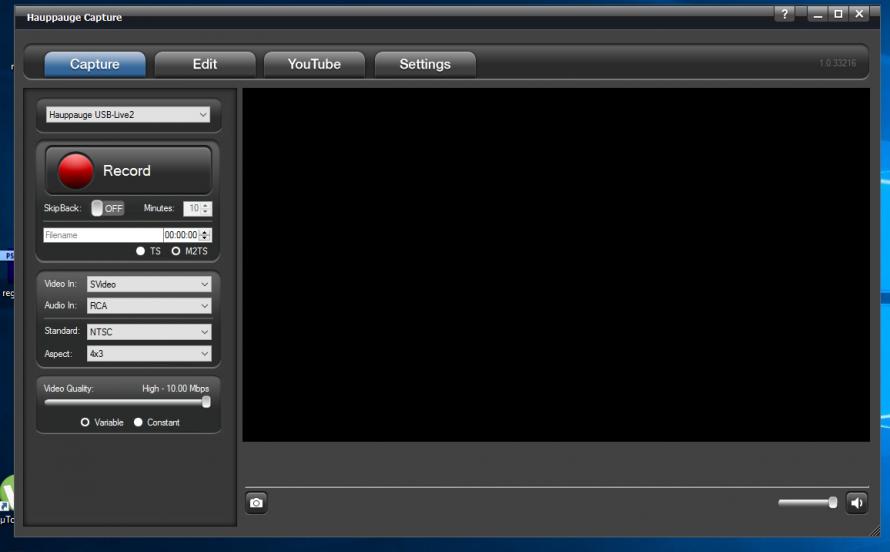

That device can capture to MPG for DVD format. Your capture was an M2TS for AVCHD. You have to tell the software you want DVD.

Hmm.. I don't really see other option.
Let me go back and check.
Will get back to you later.
update:
hi,
no other option to chooice
only had these

You are using Hauppauge Capture, which captures only to M2TS or TS. Use WinTV for MPEG capture.
From the left-hand side of the Haupppauge USB Libve-2 QUick Start Guide:
