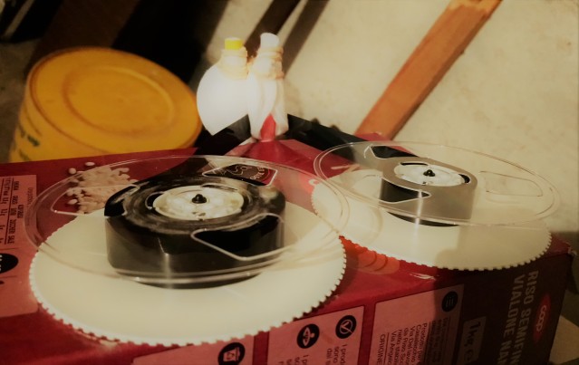

Hi,
I would like to share my manual cleaning machine: I use two markers to rotate the tapes and clean the tape with swab and isopropyl alcohol (99.9%).
The first round is not so bad, but I did it twice (forward and backward) to get a better result.
It took a huge amount of time, but for a single tape (with a low duration) is feasable.

Hi,
It would be helpful if you could post a short clip of your manual cleaning process on Youtube and share link here :-)
