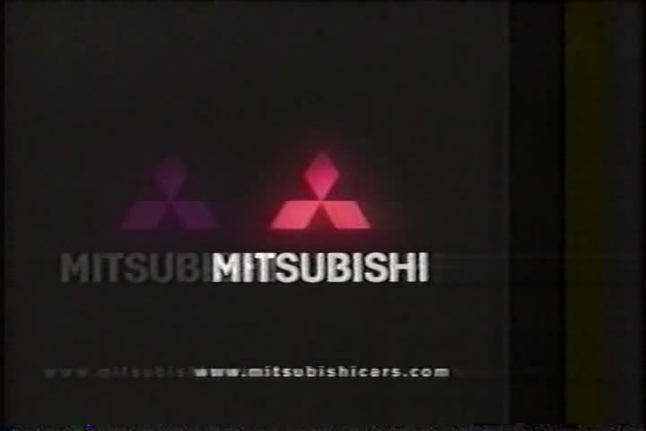

Noticed this on a few VHS tapes I have. Would love to know what filters to use to either remove the ghosting or align the layers correctly.
Any help is appreciated. Thank you!

This looks like severe ghosting (and good luck to fix that!), generally ghosting is only a few pixels away of the object.
If you have this throughout your tape, just give up

themaster1 is correct, but there are other problems. No one would be able to determine very much from a compressed jpg still image. There is macroblocking, mosquito noise, and so on -- how much of that came from jpg compression and how much is actually on the tape can't be determined. One could say little about frame structure or anything else -- a still image (capture method unknown) and a moving. unprocessed video sample are two different things, especially since a jpg has no "fields". We know nothing about the video source or how it was played or captured or originally recorded, etc.

It's ghosting, and I've had some success with removal methods in the past. I'd like to try my methods on this clip. Upload a sample, and I'll see what can be done. I've fixed clips that ugly before!

I've already got the hard part done. Most of the ghosting is gone.
But instead of using Premiere/Photohop, I want to use Avisynth for that part too. I have a post at both VH and Doom9:

I know you know Avisynth, so is this something you've ever come across? It's be a heck of a lot easier than the Premiere/Photoshop method. That's really the only outstanding issue. I did this quick samples with VirtualDub for the screen cap, Photoshop, and the Avisynth overlay. But it's rough, I know it can be done better.

Alright, here's the sample.
The ghosting is not 100% gone, but anywhere from 50-90% (depending on the scene) is now gone. I'll create a guide tomorrow, as well as give more details on how it's done.
Several tools were required:
- TMPGEnc 2.5 for the first-pass removal
- VirtualDub for the sample screen shots
- Photoshop for the matte (PSD editing, save as PNG)
- Avisynth for the second-pass removal (mostly NR and applying the matte)
- VirtualDub for the final pass, including standard VHS fixes
It's not too hard, but you can get as detailed as you want -- and therefore as time consuming as you want.
