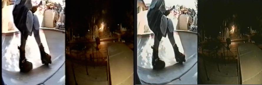

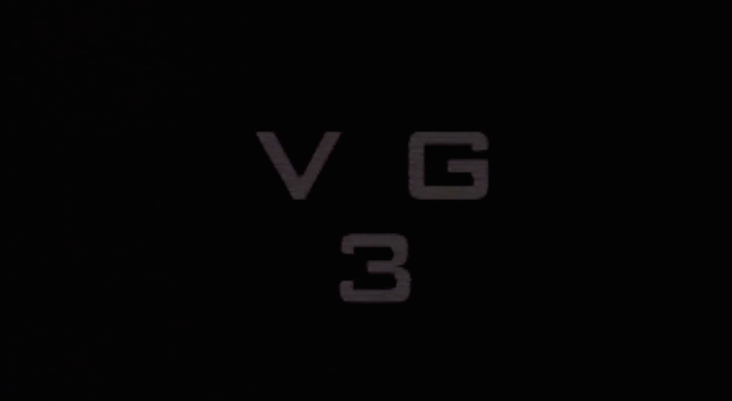

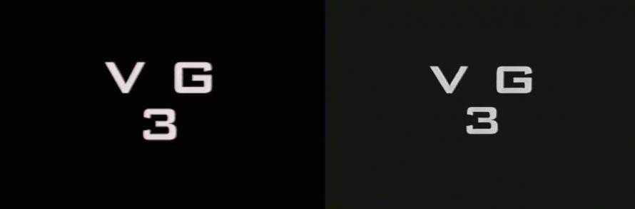

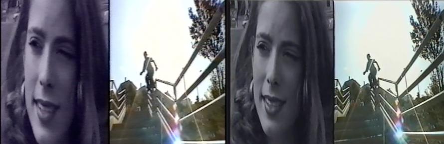

here are some screenshots, per sanlyn's suggestion.
Left: My raw capture in FCPx. Right: 3rd party source
On my capture during the title screens I noticed horizontal lines in the lettering when it faded into the next title screen. Also the words weren't perfectly still.

Originally Posted by pinheadlarry View Post
lordsmurf, when you say the 'raw dv file', how do i achieve that? I am capturing with FCPx, so would i save it from there in the DV format?
If you keep all your media in your project files, when you import from the Canopus, it will save an original DV copy inside the project file. If you right click it and click show package contents, you can find it there.
Your left side is interlaced, the right is de-interlaced.
The following users thank premiumcapture for this useful post: pinheadlarry (07-19-2014)
07-19-2014, 03:56 AM
I don't think that's correct. I'd want to see a sample first. From the look of it, the LEFT side has obvious deinterlace "jaggies" from a basic drop-frame method. And the RIGHT is simply showing an interlaced motionless area.
To be honest, they both look deinterlaced. I think a preview deinterlacer is involved here. Meaning screen caps will be useless.
The still shots are a start, at least. But I think you can see how difficult it is to work from still captures. For instance you say the title letters keep moving, but as you can see in the screen cap they don't move at all (!). Meaning, what does "move" mean? Rapid horizontal jitter of the letters, the entire image hopping up/down, etc., etc. ? There's a big difference between a single frame and frames in motion.
Something else to keep in mind: you can't analyze motion problems from a still frame, but you can get a ton of info by watching frames move in sequence, especially at 1 frame every 1 or 2 seconds, or slower. You can also enlarge frames for viewing -- you can do that with images, too, but how much has changed between the original, unprocessed frames and the jpg compression in the images posted? Each image itself is second-generation (at least) and is lossy re-compresseed.
All the images look deinterlaced to me.

Those lines and other noise come from improper interlace/resize, and the denoising in the other images looks rather destructive without accomplishing all that much (but as I said, it's really tough to tell from resized jpg stills).
BTW, that "VG3" image is 732x401. Did you resize it from the original? How was the image made?

I will try to be less broad with my description of the 'moving letters'. I've been rewatching it and it seems like the color isn't 'solid' or 'still' inside the lettering. it's sort of fuzzy inside, but a very minimal amount. Also, here is a better example of the horizontal lines i was referring to during the fade out.

For the stills, i just did a screenshot (cmd-shift-3), cropped them, and uploaded to imgur. Is there a better way? Usually the easiest is not the best..

Re-upload but don't crop, it can distort the image and give the impression that there are other problems. The easiest way is to open the video and take a screenshot and upload it directly to the forum. The file will be in PNG which is better than JPEG.

did as you described premium. i did not resize the quicktime window, i wasn't sure if it would effect the results.
Also, capture it seems you are very familiar with what I am trying to do with OSX. Do you have a particular workflow, or maybe can you point me somewhere that can give me more information on this subject?
Download and install VLC for the Mac, Quicktime is going to work against what you are trying to do and you don't want to be taking screen grabs. VLC will take the image from the video itself. The window will affect the final image, I meant don't crop any black bars
