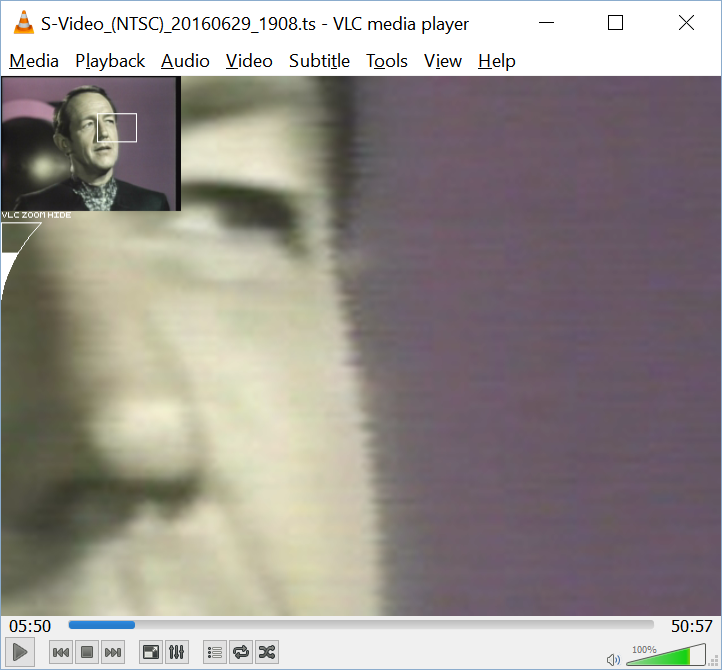

The output signal is running through a Videonics MX-1 to provide full frame TBC. The output looks rock solid, however I've noticed some artifacts that are present only in the time base corrected output. Namely some fuzz/noise on the border of objects. I'm wondering if this is inherent in all TBCs or if there is a way to improve it?
I noticed that Datavideo TBC-100 and TBC-1000 are recommended as well as the AVToolbox AVT-8710. This got me wondering if the issue could just be the TBC. However, if I run relatively good video from my SVHS player into the MX-1 it doesn't exhibit the same kind of artifacts.
Example:
Would a different TBC eliminate the noise on the edge of the face? The noise is not present if captured directly from the CED player, but the flagging is unreal.
Any thoughts are greatly appreciated!
It's possible, but personally I would use one of the DVD recorders known to be good for passthrough. The full-frame TBC models don't do much horizontally.

I do have a question about line vs. full-frame TBCs. You mentioned full frame TBCs don't do much horizontally and I've seen this mentioned other places. My main reason for using the MX-1's full frame TBC was to correct some heavy flagging/jiggling in the video:
Before: https://gfycat.com/UltimateThriftyIsopod
After: https://gfycat.com/BrownSpitefulBlackbear
To me that's a type of horizontal error, though I'm just learning about line vs full-frame TBCs. Will a line based TBC do a better job of lining up the edges and eliminating the noise on them?
Ignore the color degradation on the "after" version. It's an older capture and the result of having to demodulate the signal through a VCR to get a composite signal and unwisely using S-Video output from composite input on the TBC. I have a better set up now that's composite video all the way through and the color is unaffected, but the noise on the edges is still present (as per the image in my first post).
I just wanted to illustrate the stabilization effect from the TBC and see if you think the line TBC will further eliminate the noise/fuzziness on object edges.

Flagging is a bend at the top of the image: http://avaa.bavc.org/artifactatlas/index.php/Skew_Error
The wiggling is horizontal error yes. There is a difference between saying full frame models don't do much vs don't do anything. But really, I was referring to the ones you were considering purchasing. It's possible the MX-1 is better at horizontal than they are. I know basically nothing about it.
