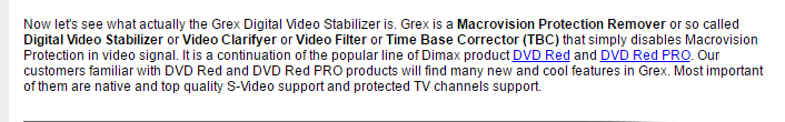

Will this be of any benefit at all? http://amzn.to/2gZnmUG The TBCs recommended are really out of my price range.
12-05-2016, 03:52 PM
The Grex is not a tbc. Does some damage to the image as well. You can save some cash and use a legacy DVD recorder as tbc pass-thru for at least a nominal level of frame sync control. The few recommended DVD recorders that can be used as pass-thru also have some line-level tbc activity and work fairly well, especially the Pansonic ES10 and ES15. Not all such machines can be used for pass-thru, and newer ones have very weak circuitry. A pass-thru unit isn't used for recording. It's hooked up between your player and your capture card, so the signal "passes through" the DVDR. They work fairly well, but they won't defeat Macrovsiion. With home tapes, macrovision isn't a problem anyway. http://forum.videohelp.com/threads/3...hat-do-you-use
12-05-2016, 04:11 PM
doodal doodal is offline
Join Date: Nov 2016
Posts: 18
The Grex website says that it is a TBC.
12-05-2016, 04:34 PM
The Grex site is BS. That is NOT a TBC. They sent us one to review years ago, and were pissed when I didn't rubber-stamp it as a quality item. It's not. It really screws with video values. Avoid that thing.
Do not post links to sites like Imgur. Attach images to posts.
12-05-2016, 04:38 PM
The Grex revises certain copy protection components of video signals, and screws up the picture doing it. It does not correct frame timing. If it did correct timing and didn't meddle with PQ, we would all be using it. Stay away from over-priced junkware.
