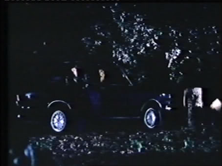

On "Come cani arrabbiati", for example, the projectionist that's doing the transfer constantly has to keep the film in the center. You'll be watching it and all of a sudden it's way to the right. Then you can tell someone is moving it back to the center. I would want to keep it in the center at all times.
Also, it is squeezed in on the sides to make it fullscreen. i.e.
I would want to expand it, making it look like:
Here is another grab for you to see the imperfections:
I did not grab any of these myself, but they are exactly what i know I am going to face. Come cani arribbiati, especially, since I own it.
The last grab I am going to post is just of one that I saw the other day. It is a perfect example of the signal I am going to have face with the majority of the tapes I own. This, is an SP ex-rental from the 80's:
I really hope this helps you understand what I need to tackle. (I know a picture is worth a 1,000 words, right?)

The John Wayne image has an unstable timebase. You need to use a S-VHS VCR with a built-in timebase corrector. I'd suggest the Panasonic AG-1970P or 1980P, or the JVC SR-series S-VHS decks. Any of your current VCRs should work fine, just play around, test the tapes in each deck to see how it cooperates.
This is probably a lost cause. Feel free to play around with the VirtualDub filter Deshaker. It's complex, and results vary wildly from worthless to helpful. You'll just need to read the documentation that came with it, and get your hands dirty testing all the various settings. There's really nothing I can teach here, it's impossibly complex and highly dependent on your source video.
