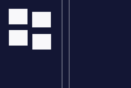

Well, part of the issue may be that you are pushing the size of acceptability. Images off the Internet (excluding "wallpapers") and video stills are both low resolution. The only exception of this may be official 720x480 releases. But homemade VHS and other homemade sources are low.
Such images can only be used rather small in the overall case image. See the image (white spaces):
While you can MAYBE go double that size, it often takes a little bit of filtering. Also remember to filter video images for contrast/color, as what looks good on screen and what looks good on paper are not the same.
For a larger image, you really have to scan something. Or create it from scratch.
