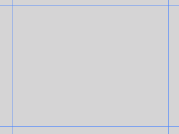

On a 720x540 matte, the non-overscan portion of the image occupies about 645x505. 720x540 is generally what you should use as your menu template. Save as BMP too.
If we use 720x480 as the base video size, the inner 645x445 is the non-overscan portion of the image. To figure out other video resolution overscans, do the math (I cheat and play with Photoshop resizing tricks to figure it out).
Everything outside of that is usually hidden. Most often, it is junk and errors, and should stay hidden.
I say "about" when describing the pixel sizes because every tv set can slightly differ. So show more, so show less. Some can even shift around a bit (show more top than bottom, more left than right, etc).

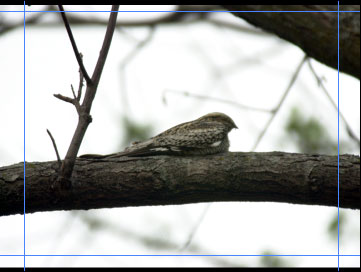

This one, for example, is calibrated SPECIFICALLY for my favorite tv set:

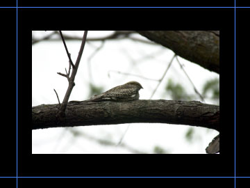

There are certain things to remember about using the overscan. Do you want your image to ALWAYS been inside overscan? If so, tuck the text/images closer to the inside, and farther from the edges. Or do you want it to be 100% safe on all tv sets? Bleed the image out.
Safe interior, item will NOT run off screen.
This is perfect technique for slideshows:
Safe bleed, item will fill screen.
This is perfect technique for DVD-Video menus:

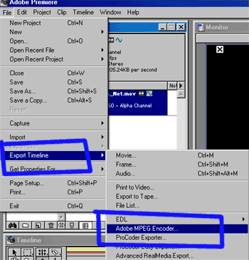

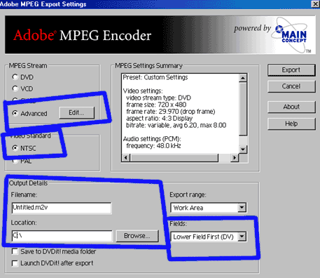

Export the time from Adobe Premiere:
Video standard in the USA is "NTSC". Output details is the name of your files and where you want to save them. DV is bottom field video.

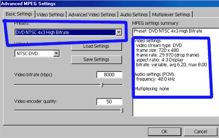

In the image above, click "EDIT" by the "Advanced" option, which brings up this screen:
Select the High Bitrate template.
