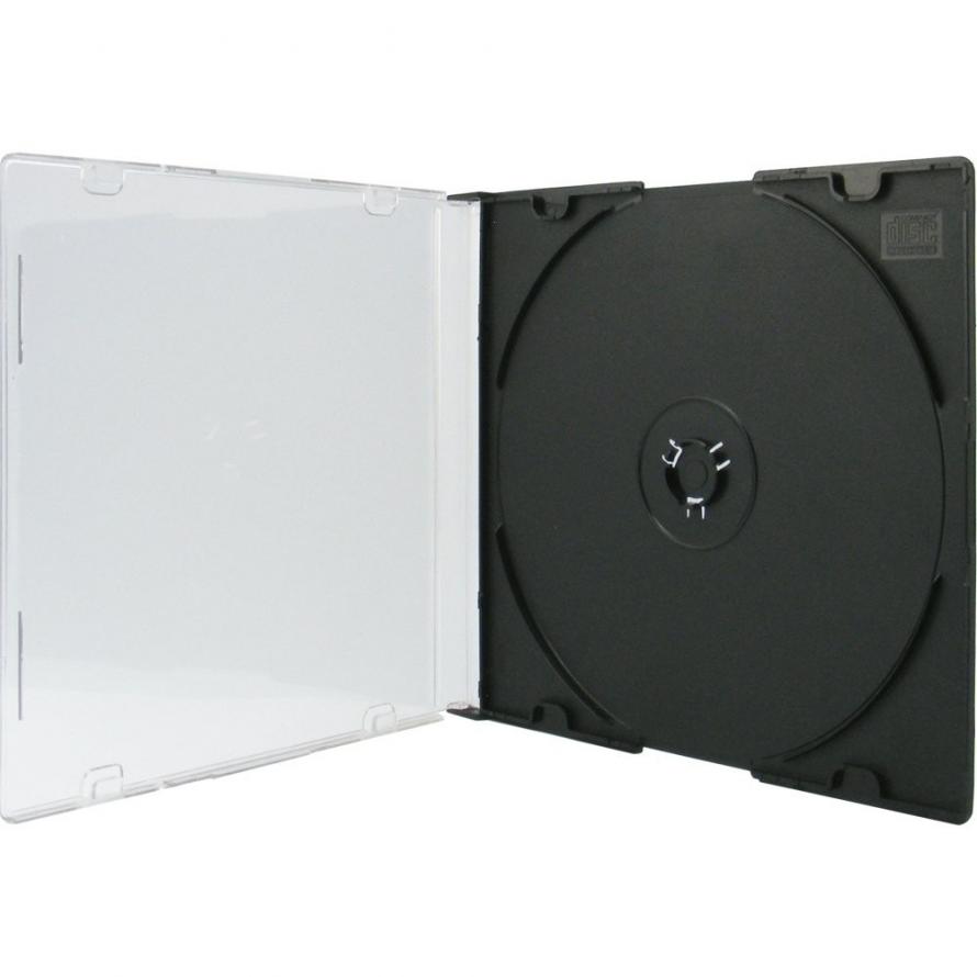

see another photo CD slim case, this case will protect the disk of light? behind is black in front is transparent (or cover) case slim cd protect light in CD/DVD?
03-22-2016, 02:38 PM
Black = fine. It's black.
The following users thank lordsmurf for this useful post: gamemaniaco (08-29-2016)

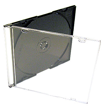

Black avoids light on the disc?
the front up of disc CD/DVD may receive light without damaging the dye?
03-22-2016, 03:24 PM
"Yes" to both questions.
