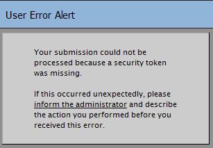

How big should the file be? When I try to upload all I get is sending request to digitalfaq. Is there a size limit?
I'm not usually so thick when it comes to computers but I have had a look at the upload instructions and I can't get it to work. No matter what setting I enter in WinRAR it splits it all into 1kb files!!
Is there any other way to get the file to you? I have a website. I can upload it there and you can browse to it I suppose.
I got it to work with HJ Split. I don't know what is wrong with WinRAR. I'll upload in a bit.
Well I still can't get it to upload--just sits there sending a request to digitalfaq. Let me try something else.
I'm uploading the files to my website. I will post a link when that is done. Maybe it's an issue with your server.
