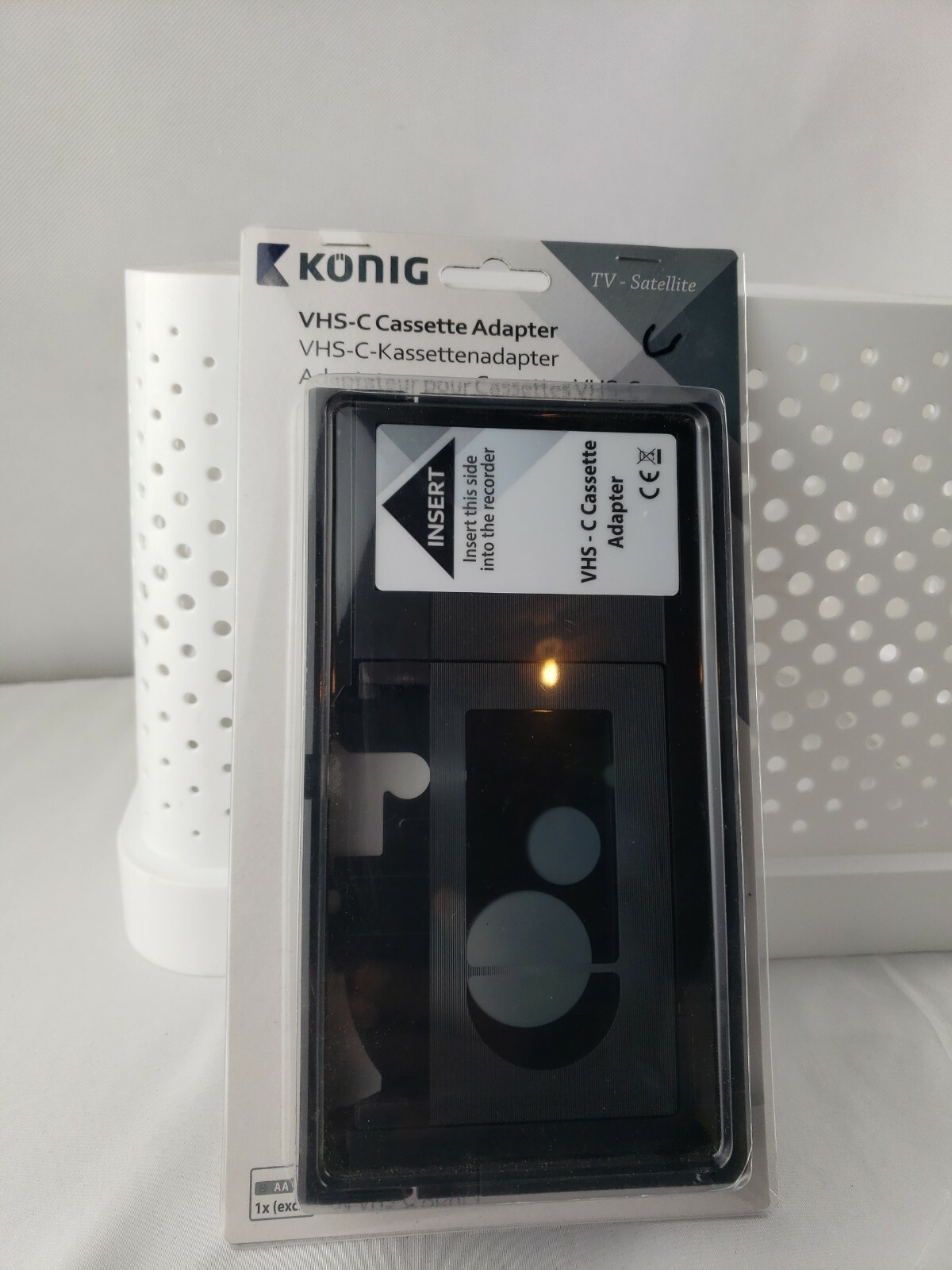

I can't find anything on that specific panasonic name. I know there are panasonic branded variants of this generic VHS-C adapter that you tend to get new when searching for a vhsc-adapter (no idea who is the original manufacturers but it's found under a bunch of different brands.) In my experience they tend to be ok, but they are a bit wonky and sometimes fail to thread the tape fully when inserting a tape into the adapter. Haven't used them with this mech though. (They also don't work properly in the Panasonic AG7350 for whatever reason.) You can spot the difference between the other mentioned models that they e.g don't have the tab that prevents inserting if there is no tape in, and the position of the slider that opens it is different.
