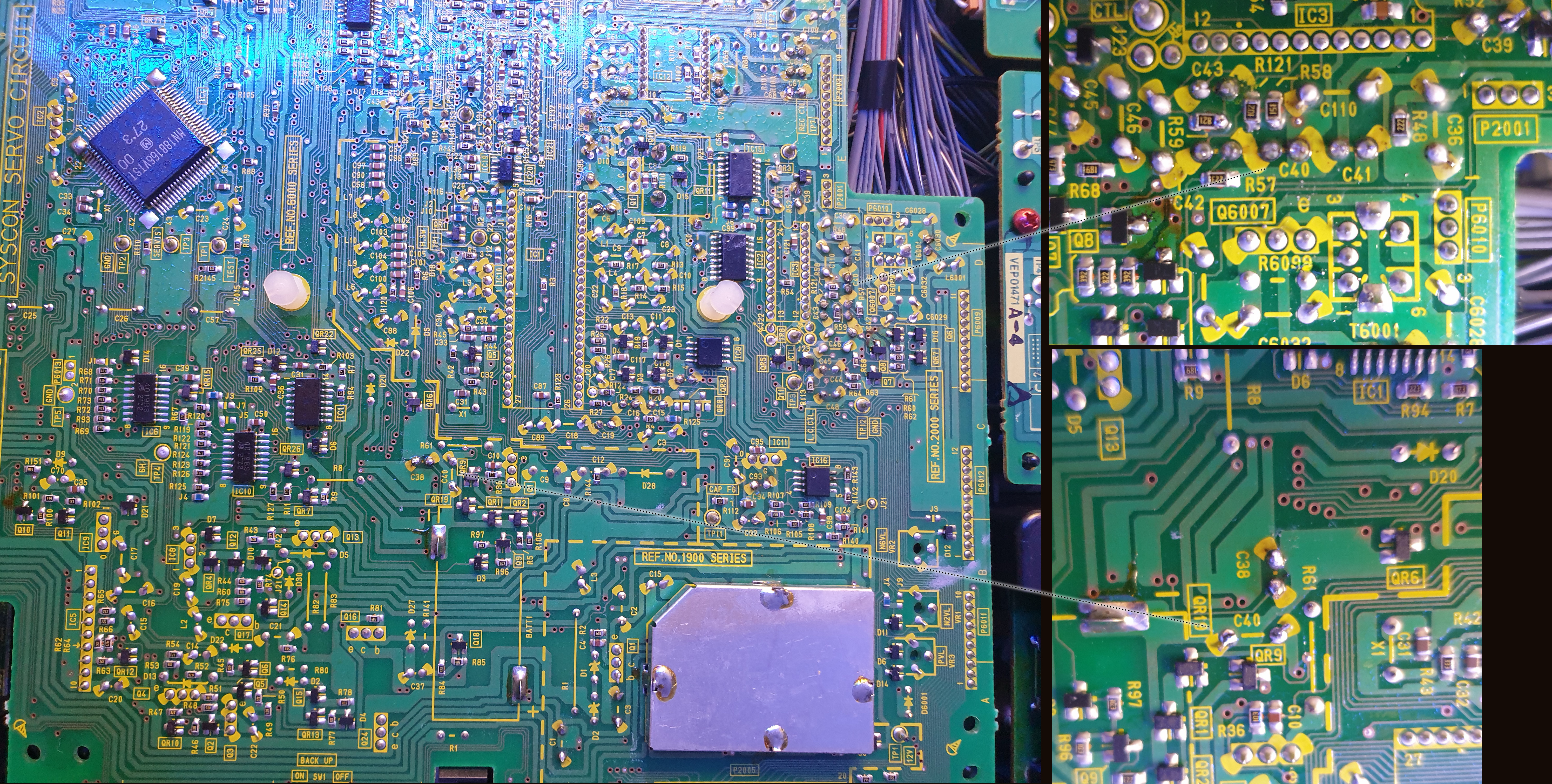

today i re-checked all caps on the servo board and i found that there are 2 C40 capacitor... ( !!! )
an high quality picture is here: http://www.wcn.it/c40.jpg
never seens something like that maybe there are different board revisions? thi is the PAL one

08-21-2023, 09:16 AM
hodgey hodgey is offline
Join Date: Dec 2017
Location: Norway
Posts: 1,685
Thanked 465 Times in 395 Posts
It's how panasonic labeled things - the boards are sub-divided into sections with 4 digit numbers, and the silkscreen around the components themselves just show the last 2 numbers so the actual numbers would be like C6040 and C2040 or similar.
