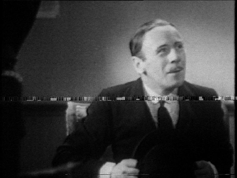

I've tried a few tapes which all playback with the same problem. It looks like this:
Thats how it looks when the 950s tracking control is in it's centred "locked" position.
(The little tracking wheel control has a centred position that "clicks").

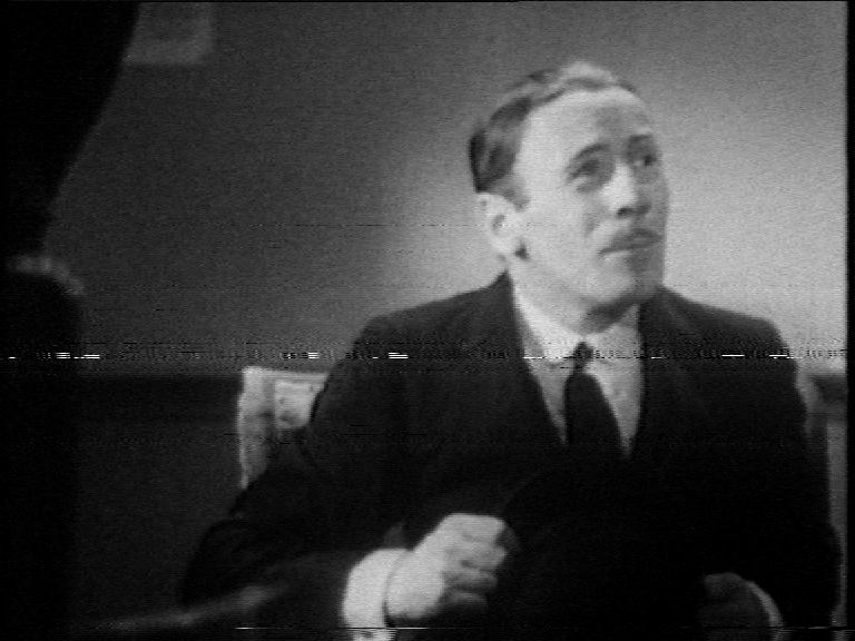

If I adjust the tracking the image looks like this:
Can anyone suggest what the problem is from the information in the first image?

The machine may need to be aligned. Do all of your tapes show the same artifacts? Is playback speed stable and consistent? Listen to the audio, if its wavering up and down, it would point to a capstan/pinch roller problem.

Could you explain "aligned"? is this something that I could do?
Each tape I tried shows exactly the artifacts. Playback speed is stable, no speeding up or slowing down.
The linear audio sounds fine. I'm having some trouble getting the hi-fi audio to playback.

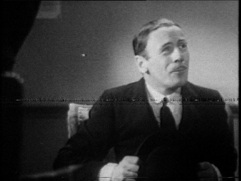

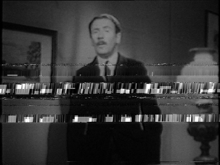

Second - I found the service manual for the HF950 on this site. (Thank you Juhok). This enabled me to remove the various bits and pieces that covered the video heads and tape path etc. so I was able to clean the heads, pinch roller, tape path etc.
Before cleaning:
After cleaning:
I'm going to try cleaning the unit again when I get a few moments free, just to see if it makes any difference.

Physically check the tape and make sure it isn't scratched. The line looks like possible tape damage/defect.
