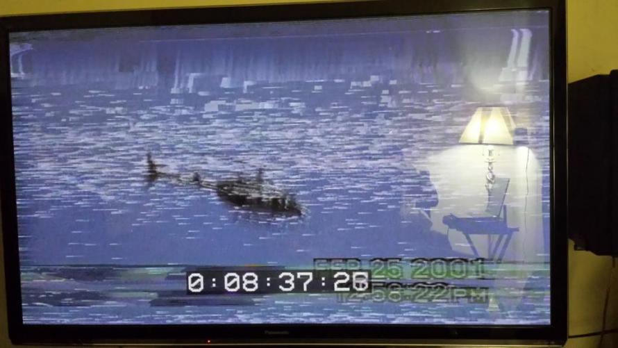

Well, I've played with the deck some more earlier today, and when I put the Hi8 tape in, the Hi8 indicator does light as it should, but the playback has noise and snow in the picture. I noted however when I put the unit in pause, the picture is clear. So it could be a head issue.
Here's a shot of what it looks like (never mind the reflected lamp image in the TV since its a plasma):
Other than that, the regular Video 8 tapes plays just fine with no issue. May see about getting the unit serviced if I can.
