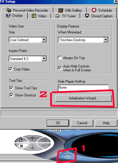

As far as the lack of sound recording, the two most common culprits are having the wires plugged in incorrectly, and having ATI MMC on the wrong audio input channel.
If you are using the coax for source, that wire is simple to plug in. If this is composite with rca audio (the yellow and red audio cables), please be sure they are plugged into the purple breakout box. The purple box feeds audio and video to the ATI card, and the audio then routes through the soundcard. The ATI card must be connected to the soundcard either internally or externally. New boxed ATI AIW cards would have come with both wires. It connects the AUX channel on the soundcard and ATI card, using the little 3-pin audio cable. The external method is using the ATI output wire bundle (black wires) and plugging the audio mini (stereo/headphone cable) into the soundcard INPUT (not MIC).
In ATI MMC, you want to click on the CHECKMARK and on the DISPLAY tab, go to the INITIALIZATION WIZARD and follow the on-screen instructions. Be sure the computer speakers are turned up and that the WINDOWS volume is not too low (or muted), so that you can hear the audio from your input VCR or coax signal. See image:

Following your procedure I was unable to get MMC 8.7 to work on my (win98se)system. What is worse is that there was no uninstall option installed with the MMC 8.7 . I tried using the windows add/remove programs option but that didn't work either. So I deleted the MMC folder under program files. But it still appears in the add/remove programs window and I can't re-install MMC 7.1 because it tells me I have an MMC already installed on my system. Can you tell me how to manually uninstall any MMC that is lingering on my pc?

Yes it installed but the TV app has only s-video and composite options. I have cable tv plugged directly into the card which worked fine with 7.1. The composite cables from my VCR plug into the purple break out box and they don't work either (but did in 7.1). Anyway, I don't think this upgrade will solve my problem of not being able to capture audio because the word "none" appears next to sound in one of the MMC 8.1 folders in the setup screen. I have the sound out cable from the AIW going into a break out box from my sound card. There is no internal connection available.
As I said in prev post, I have tried manually to uninstall the MMC 8 and it didn't work. Now if I try to reinstall the MMC 8 I will probably not be able to because it will detect a previous version as it did when I tried to go back to 7.1. I think if I can get it to be removed from the Windows add/remove display it might work but I don't know how to do that. Is it somewhere in the registry? I'm not that savvy.
