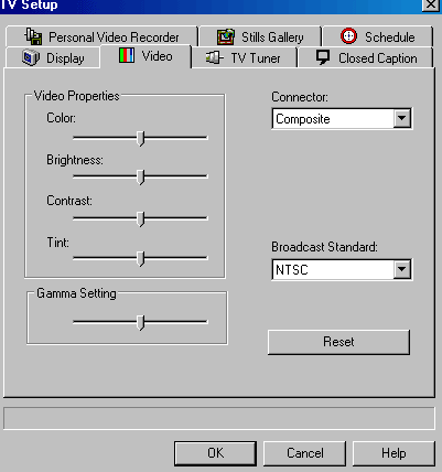

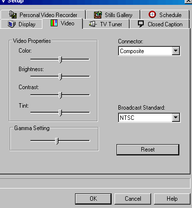

I seem to have hit a snag, trying to record at various gamma settings.
Right now, changing gamma varies the viewed picture quite nicely. But, immediately upon starting to record, the gamma value seems to reset to its default of zero. I see it in ATI TV window and later when I view the recorded video. When I stop the recording, the desired gamma value is restored to whatever I'd set it, and therefor the picture brightness.
I was previously able to make changes that "stuck" in the registry here:
HKEY_CURRENT_USER\Software\ATI Technologies\MultiMedia\Features\TV\Video\(Analog TV Tuner;Composite;S-Video) "Bright"=000000xx
And I thought:
HKEY_CURRENT_USER\Software\ATI Technologies\MultiMedia\ResMngr\ "Gamma"=000000xx
would do the trick for gamma, but it only seems to change the "viewed" picture, not the recorded material. Forgive me if I'm missing something - it's late and I'm exhausted, and I hope this makes sense - is there a solution to this?
