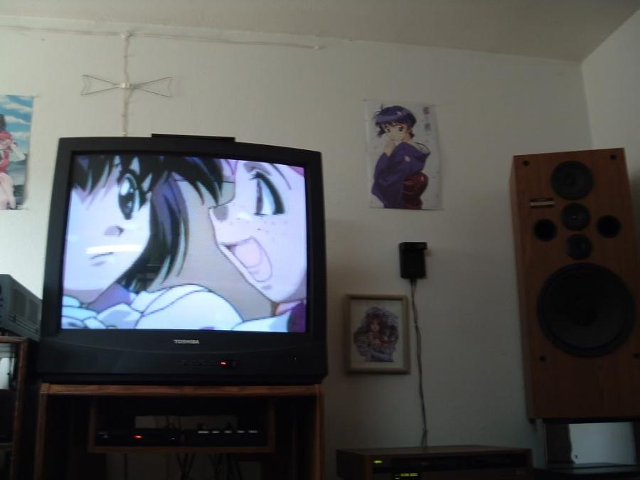

Tasuke, I have tried over a dozen SVHS tapes and they all have the white streak problem. I also tried the same tapes in my DT100U and my V101US and they don't have this problem. I have done thorough research on this machine and nobody has said they had a white streak problem with this machine. Could it be that the machine is out of alignment on SVHS? Should I try to contact the seller at all? I really think the deck looks to be in new condition, but having another machine with a white streak problem really irks me. Can any 8000U users help me out with this?
05-19-2011, 10:09 PM
No, that's not an alignment issue. That's a head issue -- often from head wear, though it can be related to magnetics and other issues centering around the heads themselves. It's not alignment, that much I can say for certain.

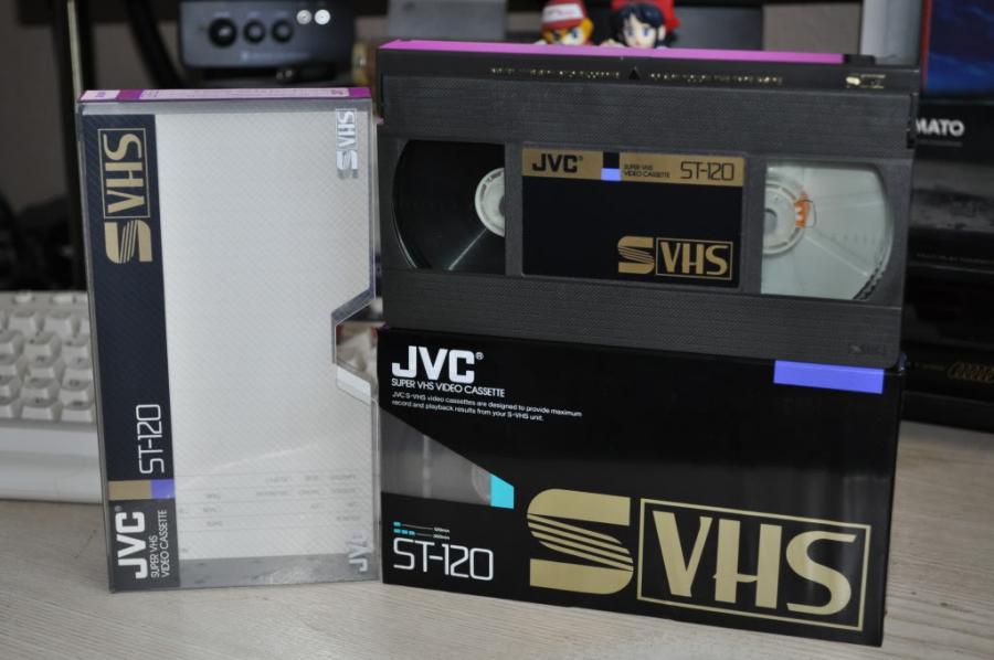

just received the cassettes today!
a word of warning, and a likely explanation
for why 1980's JVC VHS and S-VHS cassette blanks are so hard to find; BAD LEADER STOCK.
yep, i have and old early 1980's JVC DYNAREC VHS, as well as these 1987
1st ed. S cassettes, and there is one thing they share in common; weak LEADER tape,
that snaps when FF or REWing all the way through to either end.
i'd be most upset about this myself, but fortunately, i have a box of MAXELL's PROFESSIONAL/INDUSTRIAL
ST-120 blanks, so i was able to successfully transplant the MAXELL S grade tape to the JVC
cassette shell.
it's, of course, regrettable that i couldn't keep the JVC cassette original,
but i'd much rather have a fully functional cassette than a non-functional broken one.
besides, my second JVC ST-120 is to remain sealed, and, naturally, original.
like i said, i have three early JVC DYNARECs that suffer this same issue,
so i was very much expecting this problem to show itself in these early S cassettes as well.
it's just too bad that JVC didn't catch on to this defect sooner...

Weak leaders were a problem with my last big capture project. The tapes were... JVC "Premium Standard" from the mid-late 80s. I had to do a few repairs from that batch due to detached leaders. The tapes were surprisingly crappy, almost as bad as the unlicensed "Made in Hong Kong" tapes my grandfather used to buy. The rollers would squeal, and it seems that someone used a rewinder on them that didn't treat them well. Thankfully all that video has been backed up.

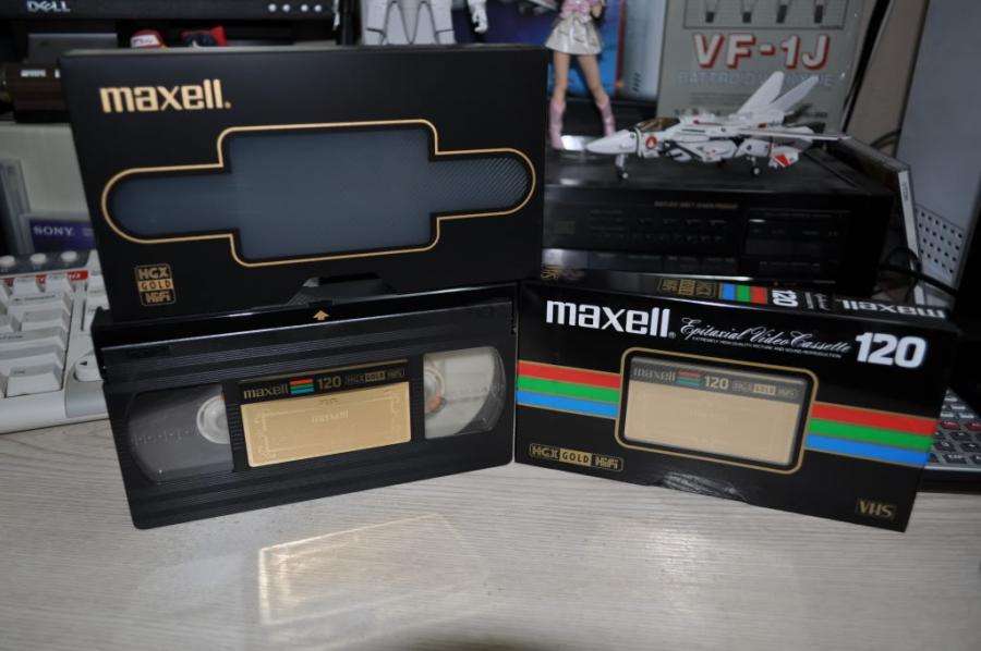

it would seem that JVC videocassette blanks, at least of 1980's production,
have a reputation for weak leader tape.
i have a set of 17 1984/1985 MAXELL HGX GOLD Hi-Fi blanks,
and, of the copies that i have opened and recorded to,
EVERY ONE has operated as brand new, and not a single one
has snapped when passed through my bidirectional wall-powered KINYO cassette winder...
also, that JVC HR DYNAREC that you see up in the top left corner of that first photo?
that cassette is a EURO PAL/SECAM edition, bought from a seller in Vilnius, Lithuania.
and it has actually been successfully passed through my winder, without the leader on either end snapping.
it was made in GERMANY too, rather than JAPAN, like the U.S. market ones were.
evidently, whatever Japanese factory JVC was employing to make their cassette blanks,
had SERIOUS issues with their transparent Leader tape stocks...

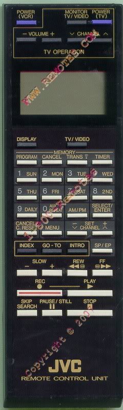

also, after picking up a copy of this remote unit from a lower-range model in the same production era
as the 8000U, (HR-D430U) i found that i actually prefer it to the 8000U's remote,
so i now use it with the 8000U;

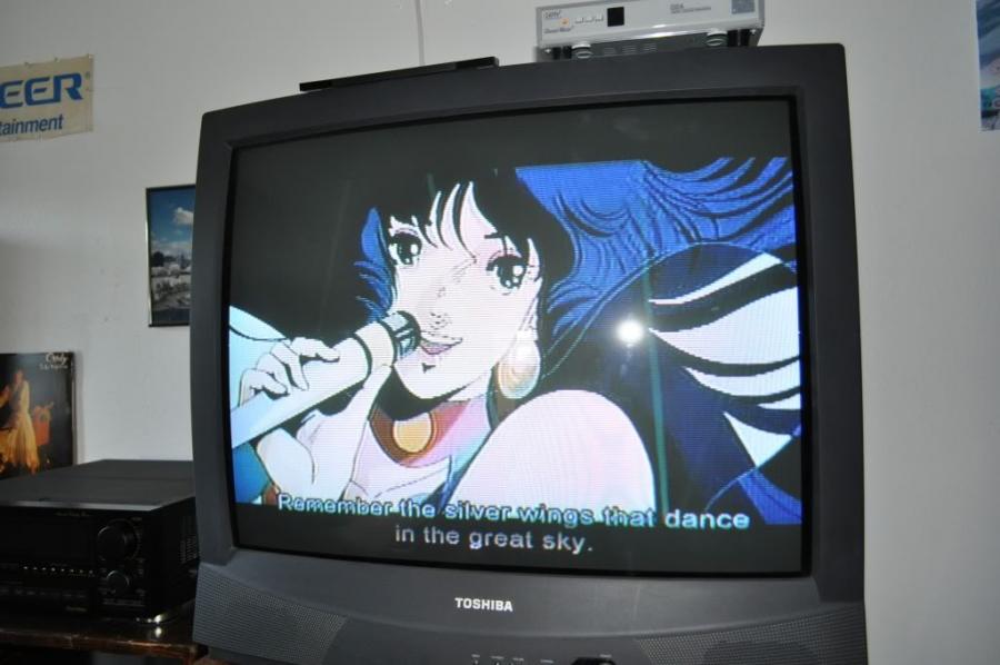

(note the vibrancy and detail in this S-VHS recording of the 2000 Anime (Japanimation) "Hand Maid May")
(also, note that i have since stepped up to a 40" HD LCD monitor, and these recordings actually hold up
just as well on it as they do on this late-nineties TOSHIBA 32" CRT.)
(even better is the detail shown in this S-VHS of the legendary 1984 classic "MACROSS; Do You Remember Love?")
