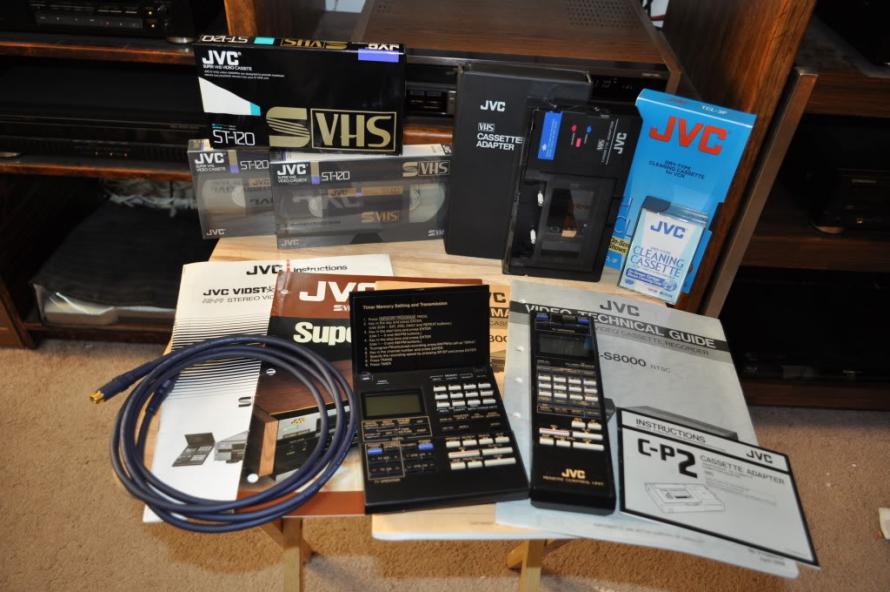

sorry to Necro, but i thought i'd proclaim that i now have a full HR-S8000U set, including the original box and TWO of the original JVC ST-120 S-VHS blanks i was originally asking around for;

HR-S8000U S-VHS as featured in 2015 Film "Joy"
