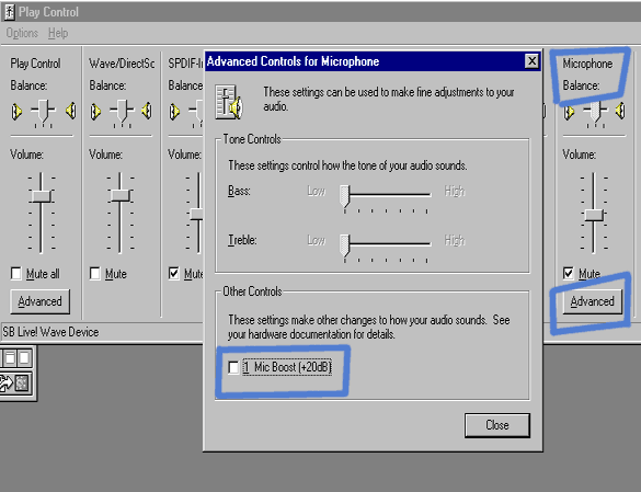

On the C-MEDIA card, the last on I worked with was a pain, and I ended up using the MIC input instead of the LINE-IN input. The MIC sounded better (be VERY sure to turn off any software/Windows amps on the MIC). Here's an image of what I'm talking about (ignore the fact that mine is on mute at the moment):
If you are using the internal AUX channel for your audio, be sure the audio cable is good (maybe buy a new one at a computer parts store for all of $1). If you are using the external plug, try the MIC over the LINE-IN.

Also make sure ALL unused audio is MUTED during capture (CD, LINE OUT, LINE IN, etc) ... the only ones in use will be "PLAY CONTROL", "WAVE", and then the input being used, whether it be "MIC" or "LINE IN" or "AUX"

I've thought about this for a few days, and went and looked at the C-MEDIA system I set up once some months back. It's fine, using the MIC with boost off, and the special features of the card were disabled (4.1, 5.1, etc) because it was badly done and messed up the input quality.
RECORD should be MIC and the PLAYBACK should have MIC and the master unmuted, all else muted (unused stuff).
