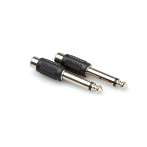

But, at least, I suggest you to buy 2 x these (you will find the need to use them in other situations too, studying your mixer further):
(they are working better then Y-like items, you will have more possibilities to use it!)
Last edited by Acden; 04-01-2012 at 12:42 PM. Reason: picture was for PC, not tape deck
04-01-2012, 12:42 PM
Are you sure those are not mono plugs? (Looks like it to me.)

Surely there are mono, and it what is needed for him. Because he uses two RCA outputs from tape deck.
He should use them on 3/4 or 5/6 channel strip.
04-01-2012, 01:51 PM
Yeah, I must be tired. Looking at the board (instead of going off memory like I was), you're right.
It's about that time of day for me -- time to step away from the computer.
