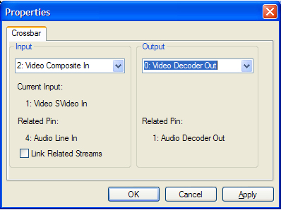

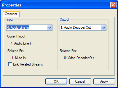

Video >Crossbar: 0:Video Comp In-Video Decoder Out
4:Audio line in-Audio decoder out

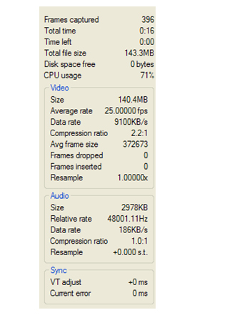

I deleted this file and started again to record the same cassette. Values while capturing: 66 000 frames captured after 44 min, 0 frames dropped/inserted; sync: VT adj +0ms; current error: 0
It indicated while capturing that there were no dropped frames or sync issues. But, playing the same AVI file on Vdub- using the internal E drive, gave me up to a ± 3 second delay between audio and video.

What I have not done in the past, prior to capturing “seriously”, was to change the crossbar. (See the 2 screenshots).
