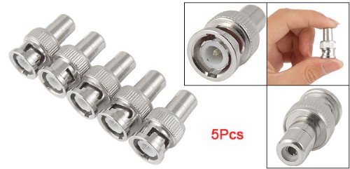

I was planning on using BNC Male Plug to RCA Female RF Coaxial Connector for CCTV Video. I'm not sure what connectors are in the back of my VooDoo...I thought they were the CCTV RF connecotrs
I have the BVTBC8. Works great when stacked with my AG 1980, no issues at all. I got it for a steal on Amazon for $20, free shipping. When I received it, it was in the original packaging and the ac adapter was new in the box, as well as the TBC...weird that it wasn't used. Can't beat $20 bucks!
04-27-2014, 05:42 PM
a BVTBC8 has BNC connectors on the back which are composite. - they are not RF coaxial
so all you need is a couple BNC to RCA adapters.
The following users thank volksjager for this useful post: deckhanddavy (04-27-2014)
This, right?
04-27-2014, 05:46 PM
yup that is all you need
