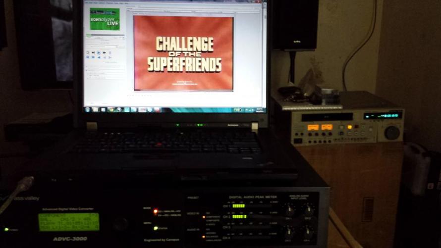

As of today I got this off Fleabay, the Grass Valley ADVC-3000 (unit under my laptop):
This is a broadcast based device that has all the pro-level connections including SDI and XLR balanced audio. It originally retailed for $3,500 but gotten it at a fraction of that price ($400), brand new in the box with included cables and manuals. This is the ultimate SD conversion device. Best deal in quite sometime!!
I put it to a very short test as I don't have everything set up right now, but in the pic I ran the component output from the Panny DS-850 direct into the ADVC-3000 and ran the balanced audio to the box as well. The 3000 does have unbalanced audio output to other devices. So far, the test capture via DV is very successful with a pretty clean picture. Plus, if DV is edited on the PC the 3000 can also write it back to tape as well (via the RS422 control). Granted I don't know how well the quality will be, but that's what experimenting is all about!

It's an interesting device, but using it just to capture DV seems like a waste, no?
Any chance you can do me a favor and attach a sample? The DS-850 is one VCR monster that I've been looking at getting for a while.
I see there's head-switching noise at the bottom in your photo though. I thought the "switching noise masking" feature was supposed to correct this the same way the JVC I have does.

The DS-850 is a great VCR unit, but keep in mind it only plays SP recorded tapes. And from past postings here on the forum, the way the heads are most homemade tapes would be better served by the 1980. I connected it to the ADVC-3000 via component and display on the laptop. The video image in the screen I would guess shows the noise since the capture window was enlarged, but playing the file back in a separate media player plays just fine (to my eyes anyway).
With the DS-850, you will have to make adjustments for playback, as its a more complex deck. Should you decide to look into one, definitely check hours and playback function. I also have the DS-840 and I had both units serviced due to bad caps.
I'll work on getting a sample soon with the 850, since I don't have the gear connected right now. I'm working on having a permanent room to where I can house all of my gear.
edit: Forgot to mention, the head switching noise can be seen more likely on non-overscan screens too such as computer monitors.
