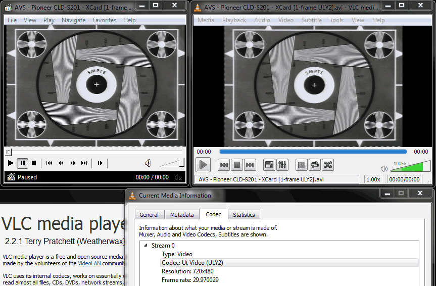

ULY2 is Ut Video's FOURCC for 4:2:2 with BT.601 colors, so for our SD tape capture purposes I'm pleased to report that VLC does support the part of Ut Video we're interested in.
Kat time I downloaded a UT sample from a website, all I saw in VLC player was a black screen. Exactly how it as compressed, I didn't boitehr too look. Played with no image in MPC-BE as well.

Kat time I downloaded a UT sample from a website, all I saw in VLC player was a black screen. Played with no image in MPC-BE as well.
Sounds like it was a blank file. Doesn't MPC-BE use installed system codecs the same way as MPC & MPC-HC?
I've attached a 1-frame sample. Since VLC by default closes any file after playing, enable:
  1. Tools
  2. Preferences
  3. Simple [bottom left radio button]
  4. Playlist and Instances [heading]
  5. Pause on the last frame of a video.
VLC has no problem deinterlacing my TFF Lagarith or huffyuv AVI's. So far.
With bob mode (Yadif 2x)? If you don't get stutter using that mode with TFF files, please do upload a short sample and share your VLC version number.
File Type: avi AVS - Pioneer CLD-S201 - XCard [1-frame ULY2].avi (254.9 KB, 7 downloads)
