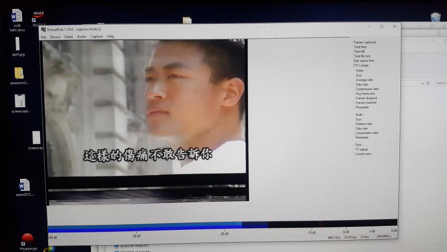

manage to find a pansonic ES10, will try VirtualDub again, later upload the video
i try to use DScaler and had problem loading it.
If i set to 720 X 576 the result is like this
Now i understand what u mean dropframe..
i notice the singer voice change.. is that what u mean ????
in tht case there no way for me to avoid
i try to set to 29.97, there is still dropframe...
