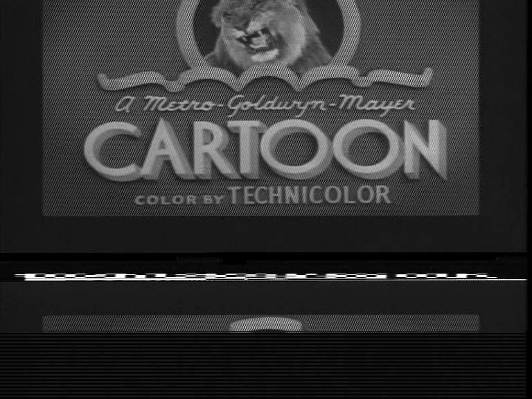

if i don't use the TBC, and try and record on either the dvd recorder or the vhs recorder, the pictures & colours are all over the place.

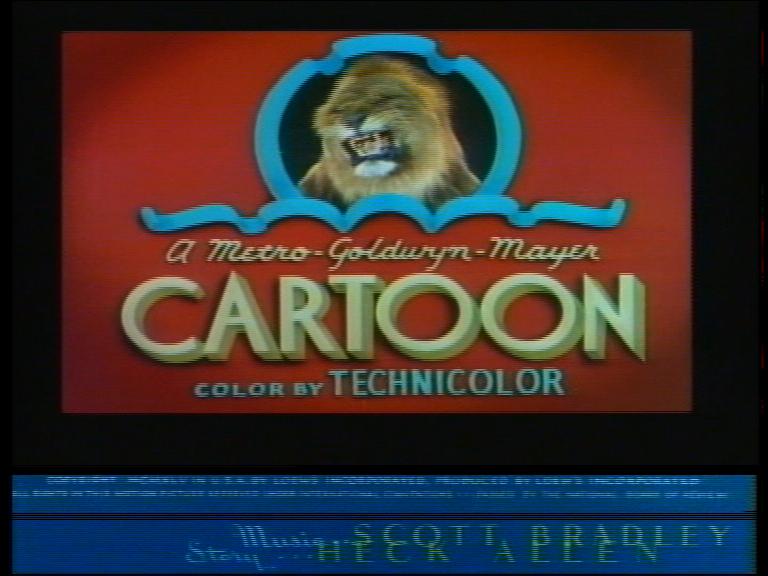

when i do use the TBC, i do get a solid picture, but part of it is off-screen. give me about 30mins and i'll do a screenshot for you to make things clearer.

okay here you go.
1st image no tbc. straight connection between laserdeic player & dvd recorder.
2nd image with tbc. this time, laserdisc player to tbc (via svideo) and tbc to dvd recorder (via svideo) as my tbc only had component and svideo ins & outs.
more of the pic to be seen. its steady and has colour.
but you can see that part of the pic is lost/chopped off at the top and some text from another cartoon on the disc at the bottom.
does this indicate to you that its macrovision?
looking at the 2nd image, do i actually have the whole pic, just that its above center? in which case, i could record it so, then process it through tmpenc to remove bottom, and centre it?

09-27-2006, 10:07 AM
That looks more like NTSC/PAL conversion problems.

09-28-2006, 05:30 AM
You cannot have NTSC source with a PAL recorder. Your recorder would need to be able to do switchable NTSC and PAL recording. Or you'll need to let somebody in NTSC-land do the transfers for you. Or spend money on one of those converter boxes, but be warned those are expensive and tend to look like crap.
