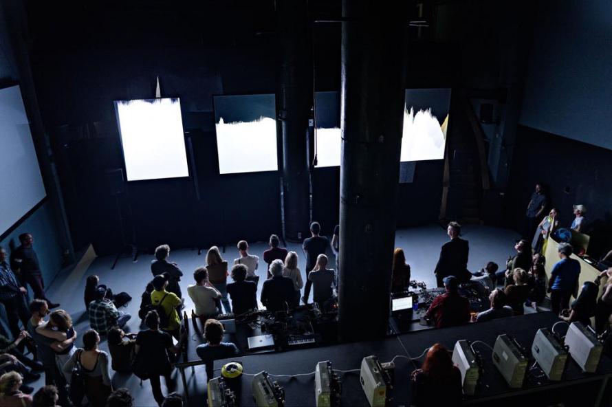

Hi all,
Maybe this might sound like a strange question, but does anybody have any experience with using audio as a video input?
I have been doing this with analogue TV's by using a strong audio signal into the AV input, and the result is beautiful distorted images. Higher frequencies produce thinner lines and lower freqs produce bigger/wider stripes. I have been using this for an audio visual art project if you are curious about why.
Me and my colleague own a Datavideo TBC-4000, which makes it possible to send these images to a video projector. By simply feeding the TBC with the audio signal and taking the output to the projector.
But, i have not managed to do the same with any other equipment. I have tried to do it with a video mixer connected to a LED TV and feeding the mixer (edirol, which is supposed to have a build in TBC), but it doesn't work. I have tried to do it with a DMR-ES10 DVD recorder. But didn't work.
I have tried to find another Datavideo TBC online, but they are very rare and generally unaffordable.
I am looking to find a relatively cheap solution to add to our TBC-4000 setup, and have more inputs and outputs to video projectors and or LED TVs. Any ideas? Thank you!
