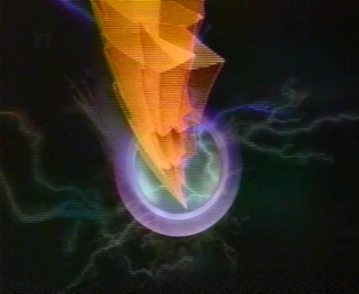

I'm capturing with a JVC S7900, AVT-8710, and Hauppage USB Live 2, using mencoder on Linux to just directly copy the stream.
For filtering and compressing, I've been using Avidemux. The real issue is that for videos that I capture that I don't intend to put on DVD, I like to deinterlace them because they are usually viewed on computer monitors or telescreens that don't play nicely with interlaced video.
I know about the arguments about having the video player do that work, but generally speaking that tends to look a little worse than a filter applied to the video in my opinion - and some of these may end up on youtube.
I've been using the decomb telecide filter with no pulldown, per the avidemux wiki, and am wondering why I end up with combing on frames with motion, such as the screencap below. One friend suggested that maybe I'm processing the fields in the wrong order - but I'm not sure.
Any ideas? Thanks!

It looks as if something is wrong with the initial capture file. I need to see a sample clip.
For disc, yes, interlaced is best. Even for TV, interlaced is best (and let the TV/player do the deinterlacing). However, for streaming, progressive is required, therefore you must deinterlace interlaced footage. Using the best possible method is suggested, and that means QTGMC in Avisynth.
Why are you using telecide?

It is possible that the capture has something wrong with it; if so that'd likely be the old tape more than anything else?
QTGMC may not be available in linux?
All that, and I'm not really a professional by any means on this, I haven't capped in a year or two so I'm not sure what's changed.

Deinterlacers get better over time. So leave it interlaced.
If you need a deinterlaced version, make a copy, use that, and don't process the master file.
There are signs that it was resized while interlaced, which makes a mess. I'd need to see a video clip.

QTGMC actually fixes it...so thank you for the pointer in that direction!
02-22-2015, 07:00 PM
Sections of MMPR are pure 60Hz interlaced, including the logo shown.
Additionally, since you're including commercials and bumpers, it doesn't make sense to IVTC. A lot of that content is also going to be 60Hz.
If you don't want to encode interlaced, you could do "double-frame-rate" deinterlacing and encode your H.264 at 60fps. Deinterlacing at 30fps is a bad idea though. The sections that were originally 24fps will stutter with a duplicate frame, 1-in-5.
