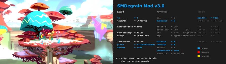

I want to bring my scripts and functions over here in case you find them useful. Also to bring attention and constructive discussion about overall Avisynth and video restoration.
SMDegrain is simply a wrapper for mdegrain, nothing fancy or magical. Just convenient automations for common tasks to get things done fast and in good quality, without forgetting some flexibility too. I created this based off my needs, and evolved from there. I took Caroliano's SMDegrain() as a base to build it because I also wanted something simple to use and straight to the point, in the same sense as the original script indicates: "To make your scripts shorter and less geeky". Think of it as a front end for mvtools2+mdegrain.
The main features of this function are:
High bitdepth denoising
Higher temporal radius (tr>3)
Contrasharpening
Interlaced support
YUY2 support
Prefilter and Motion Filter support
Motion Vectors Globals Input/Output
RefineMotion Option (MRecalculate)
+some more little options and any combination of the above supported
Everything is OFF by default so you just type smdegrain() and it works, but as soon as you start setting more parameters on you will find to need more plugins and scripts. To run it you will need at least mvtools2 and masktools2. Read on dependencies to know more.
A simple SMDegrain() call would be equal to:
super_search = Dither_Luma_Rebuild(S0=1.0,c=0.0625).MSuper(rfilter=4)
bv2 = super_search.MAnalyse(isb = true,  delta = 2, overlap= 4)
bv1 = super_search.MAnalyse(isb = true,  delta = 1, overlap= 4)
fv1 = super_search.MAnalyse(isb = false, delta = 1, overlap= 4)
fv2 = super_search.MAnalyse(isb = false, delta = 2, overlap= 4)
MDegrain2(MSuper(levels=1), bv1, fv1, bv2, fv2, thSAD=300, thSADC=150)
As you see, nothing too outrageous, just a nice good code block you save from typing and hence human induced errors.
I have to specially thank cretindesalpes for bearing my incessant questions related to this function.
enjoy!
