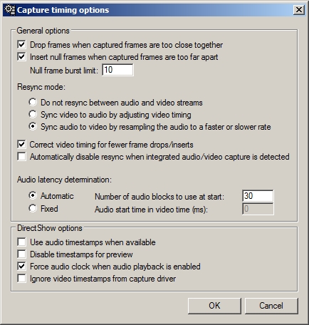

Post a screenshot of your VirtualDub Timing settings?

I completely missed those settings and it looks like it could well be the cause of the audio bug.
What are the recommended settings for my setup?
  #33
03-03-2016, 06:14 PM
Do not resync between audio and video streams.
Also never enable audio preview while capturing, in case you were using that.

I changed the setting but I still get the audio bug.
I use the Intensity's RCA outputs for audio playback.
