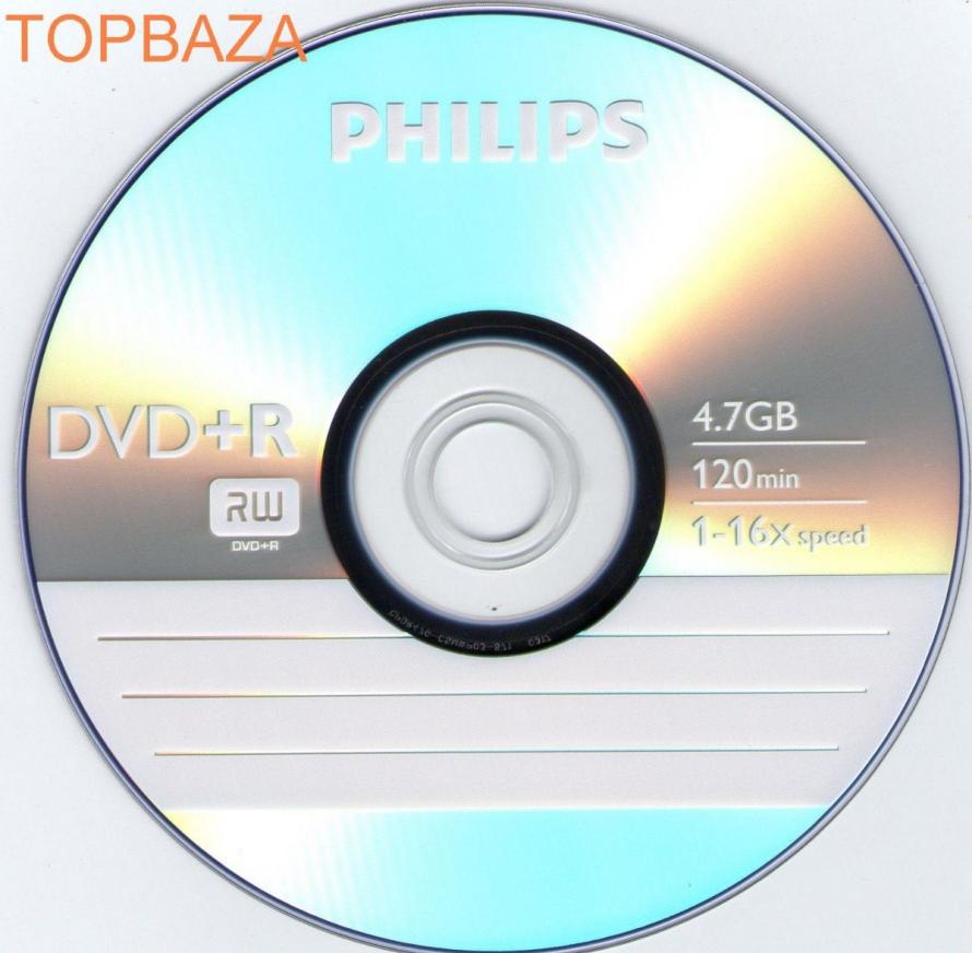

1 I still do not understand why the cmc attendant told me via email that my philips dvd + r 16x was cyanine, he said the cmc manufactured dvd + r 8x was AZO rise above 8x was cyanine, how do you know if this identifier philips 16x dvd + r 's rise ? has some feature on the disc ?
2 cmc also the attendant told me that philips 16x dvd discs manufactured by it has a life of 30 years using accelerated testing and stored at a temperature of 25 degrees and humidity of 30-50 % but I can not control the humidity and temperature and they oscillate much here where I live the temperatures here can reach a maximum of 40 degrees and when it rains the humidity is high
my disc:
  #54
02-09-2014, 11:31 AM
The CMC person didn't know what he was talking about. Which is really sad, since he works there. Then again, I'm not surprised. CMC media is mostly crap. It probably is the result of having employees that don't know anything.
